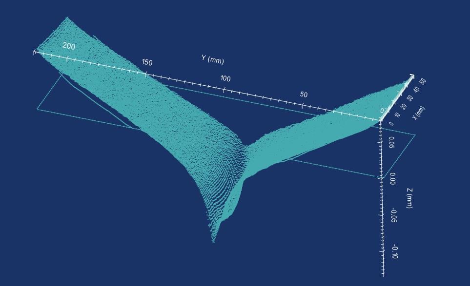

      Hello Peter,
      It is the scan of a surface, created by an EDM wire cut. The idea is to recreate the stresses that led to the deformation corresponding to the surface. Not sure I could extrude a solid body from the surface data and then "flatten" it and calculate the required stresses.
      - the .geo file is created by gmsh
      - the surface data by an open source python code

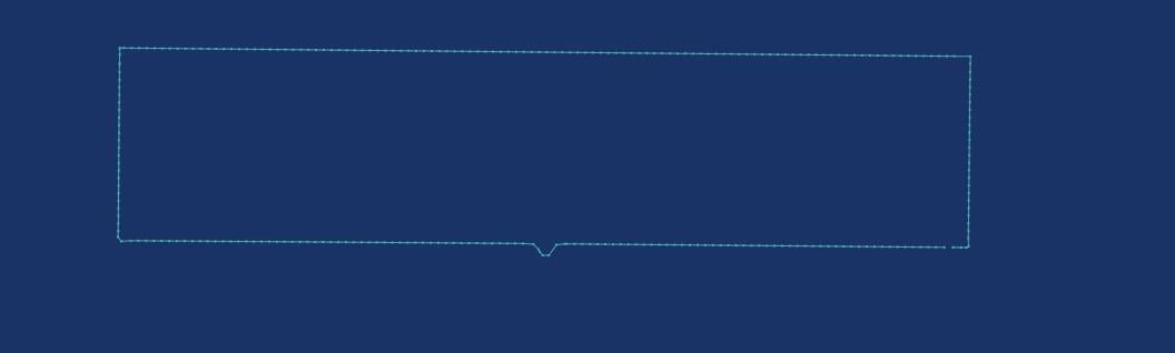

      please find enclosed the surface example,
      and outline:
      Thank you for help!

      Is the outline the outside of a part or the inside of a hole in a part?
      What analysis do you want to do of the geometry?
      Peter
    • MaximilianSP
      Hello Peter,
      indeed and it is the cutting process used for the contour method. The outline is the outside of the part. So basically I would like to extrude (in this picture, out of plane Z) the outline to create a solid. Then I want to apply on one of the front surfaces (xy) the fitted surface as displacement boundary condition.
      The idea is to analyze the stresses that result in the displacement described by the surface either by:
      - flatten the surface
      - apply stress that results in the displacement shape
      Max

      After the wire EDM, there is a small peak on one side of the body, is that right?
      You could create a second body with a flat face, and press the wire EDM body against a flat surface and see what happens to the material in the peak. It will get squashed if you have a material model that includes plasticity.
