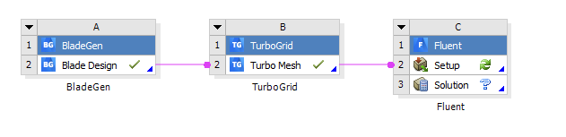

SubscriberHello everyone,
I have a problem when transfering a mesh from TurboGrid to Fluent. As you can see the grid is validateed and there is no any warning in the TG module. The maximum number of cells for the academical license is not exceeded.
June 8, 2021 at 3:27 pmrfblumen
Ansys EmployeeTry this:
-Break the connection between TurboGrid and Fluent on the WB project schematic
-In TurboGrid, go to File->Export Mesh...
-Save the mesh with a .def extension to the User Files folder in WB
-In Fluent, go to File->Import->CFX->Definition File and point to to .def just created
June 8, 2021 at 5:14 pmGonzalo_RH
SubscriberTHANK YOU VERY MUCH!!!!!!!!
