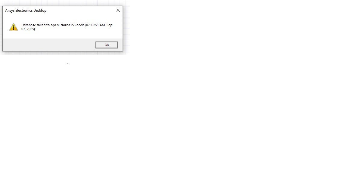

      Hello. I have a question. How do I import a 3D AutoCAD DXF file into Ansys Electronics, considering that the Ansys version is Student R2 2025? Every time I try, I get "database failed". What other steps need to be done besides saving the file in DXF format and then importing? Thank you!"

      AEDT does not support importing 3D DXF files. The recommended format for importing 3D CAD data is STP (*.step, *.stp).
