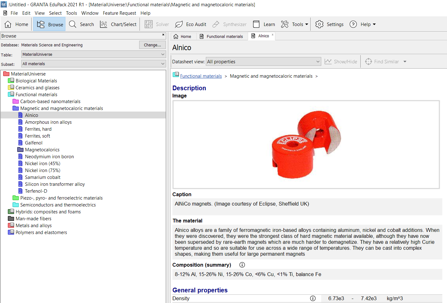

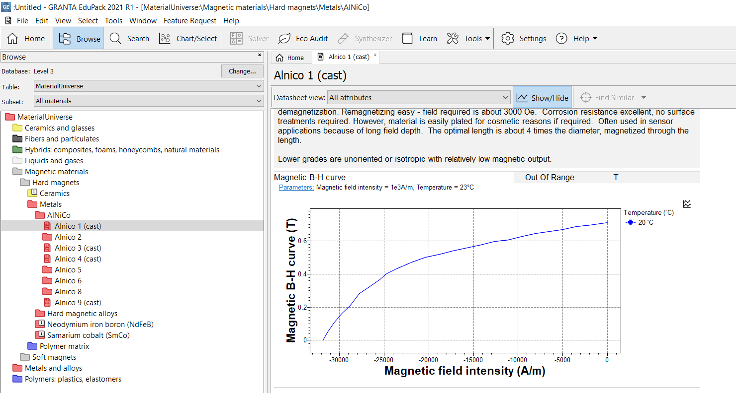

June 28, 2021 at 3:32 pmDavid Mercier
Ansys EmployeeHi, you can find some data about magnetic materials in Granta material libraries (generic data and curves data, with B-H curves...):
In teaching projects: https://www.ansys.com/products/materials/granta-edupack
In research projects: https://www.ansys.com/products/materials/granta-selector
