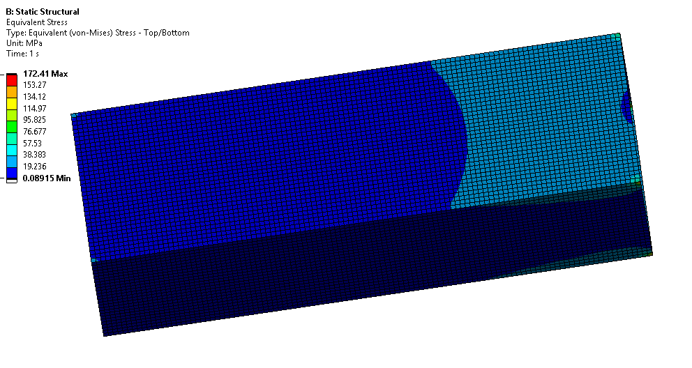

I am working in the buckling analysis of this beam. I set up my boundary conditions and got some results.

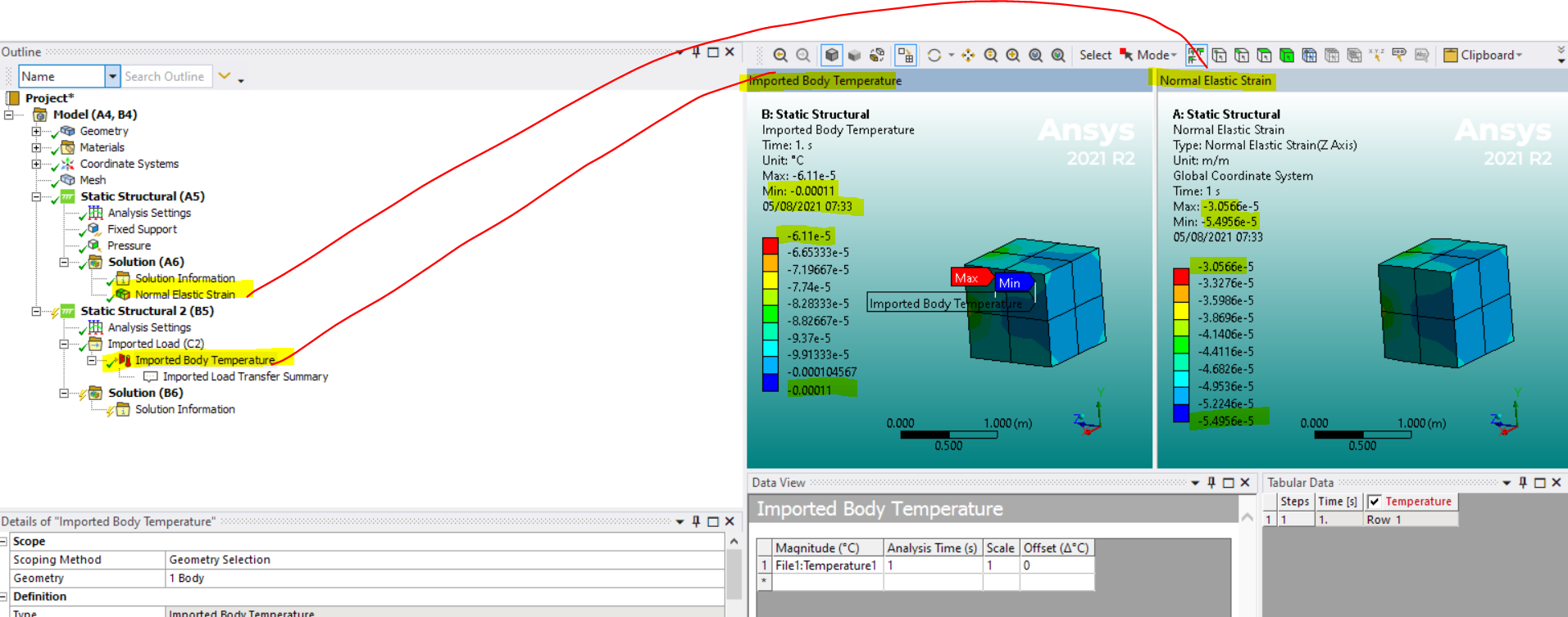

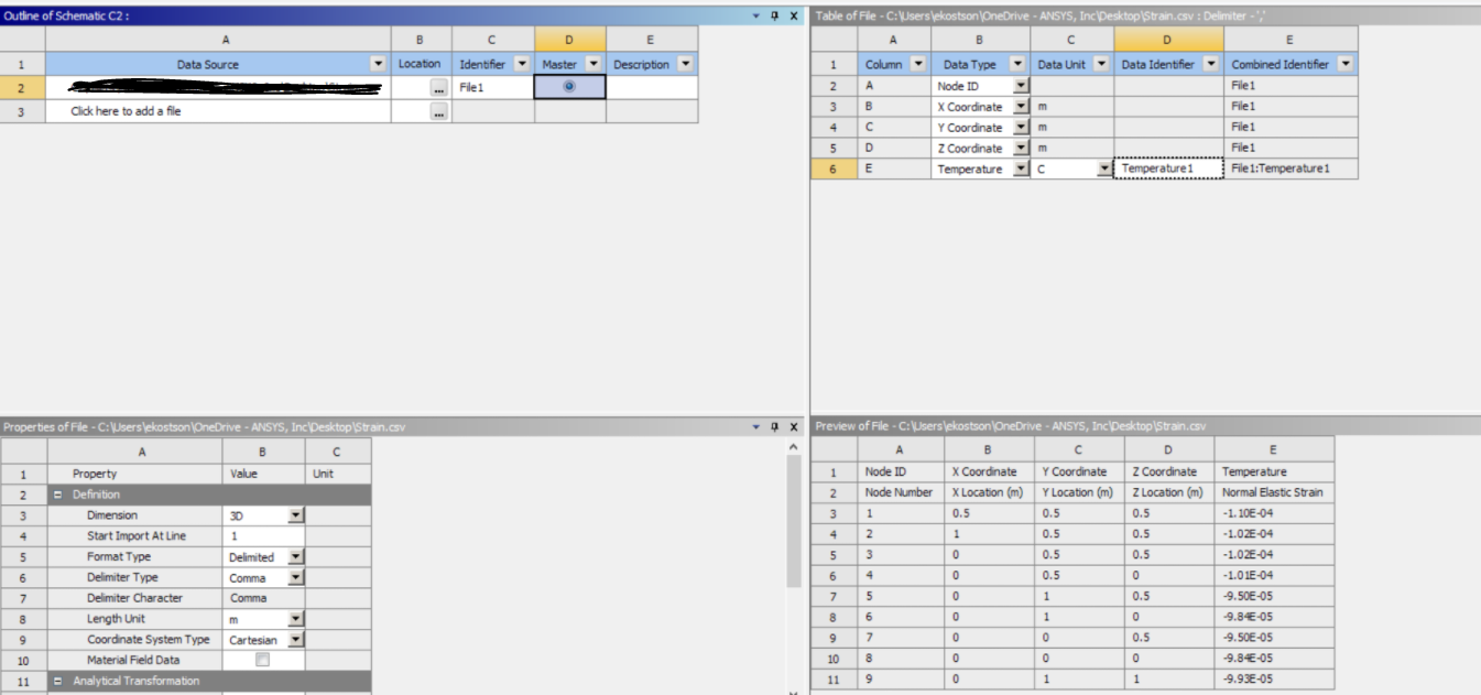

Best way is to do as follows .
create an external data system and link it to a new analysis:
in the external data import your file (needs node nr, X,Y,Z, and values) as temperatures (units do not matter here ) - in this example I have taken Z strains and multiplied them by two in excel (see help for external data for more info), and said that they are temps:
finally import the loads - as we can see the left result (imported load) shows twice the strain as it should

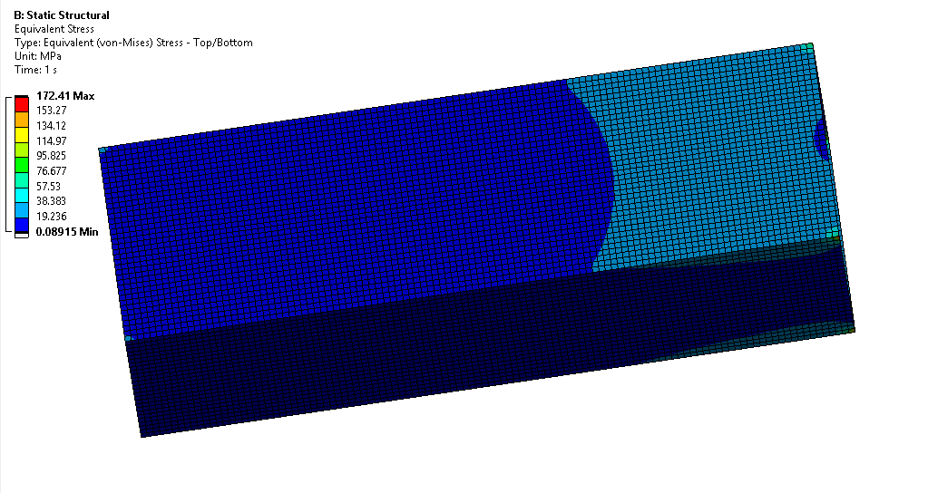

For example, I am trying to get all information from Here
Extract all information possible from the results(Equivalent stress).
Use all the information and use it in an empty model
So, I can get the same result

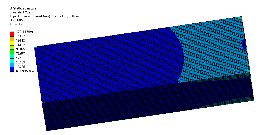

Something similar to:
If i can take the data (in my case strain energy), I would like to manipulate this data and use it in my model so I can get:

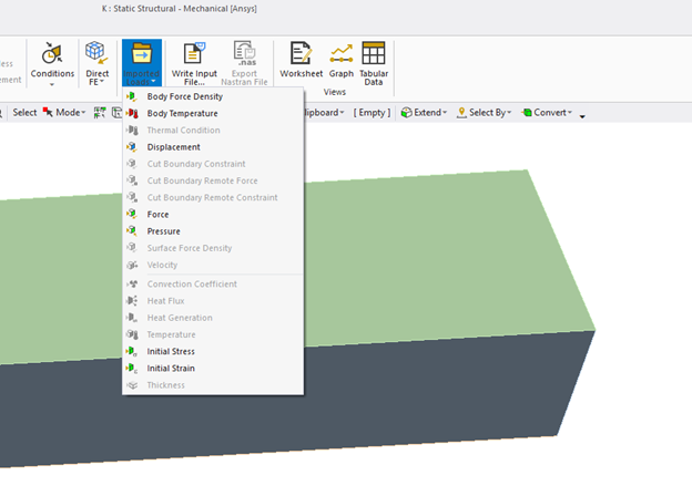

However, there is not more available options in the Imported loads option in Static structural.
Is there anyway how I can create custom results using functions or any tool in ANSYS?
