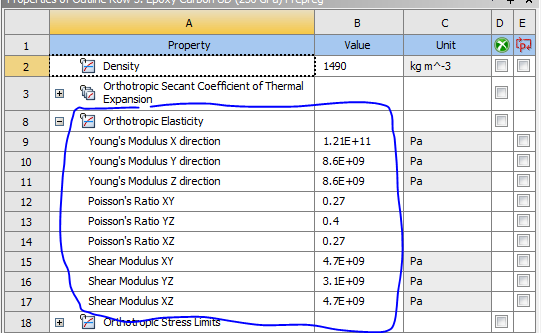

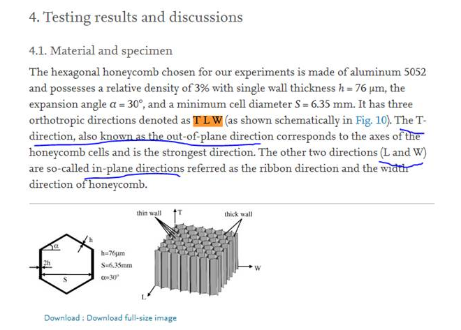

Ansys EmployeenUsing this reference https://www.sciencedirect.com/science/article/pii/S002076831000404XnT is the thickness direction. This corresponds to Z in Engineering data (EZ)nL and W are in-plane directions which could be X and Y directions in Engineering data (EX, EY)nIn Engineering data, you need to specify all 9 properties.nExample:n
You can compute the missing propertiesnCheck this help page and see if it helps: 2.1. Structural Fundamentals (ansys.com)nn
