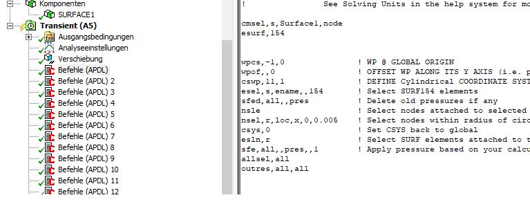

      Hello, I try to implement a moving pressure load with a circle shaped area, which is moving along the Y direction
      I failed to take the circle equation into account regarding the apdl script
      Is it possible to implement the mentioned restrictions?

      Try the below steps:
      0. Create SURF154 elements on the face where you would like to apply this pressure.
      1. Divide your simulation into number of load steps, say 10 (more number of load steps --> more resolution of the moving pressure load)
      2. At each load step,
      • Create a local cylindrical co-ordinate system at a center of the current circles position.
      • select the SURF154 elements and nodes attached to these elements
      • Re-elect nodes in the created cyl co-ordinate system within radius of the circle, using X co-ordinate (radial)
      • Re-select SURF154 elements attached to the selected nodes
      • Apply Pressure value (calculated based on your equation) to the selected elements
      • Go to next load step
      I have pasted a simple script for step 2, you can use for this purpose (to demonstrate the steps - please customize according to your need).
      wpcs,-1,0		! WP @ GLOBAL ORIGIN
      wpof,,6 ! OFFSET WP ALONG ITS Y AXIS (i.e. provide current position of center of circle along Y axis)
      cswp,11,1 ! DEFINE Cylindrical COORDINATE SYSTEM @ WP ORIGIN
      esel,s,ename,,154       ! Select SURF154 elements
      sfed,all,,pres          ! Delete old pressures if any
      nsle                    ! Select nodes attached to selected SURF elements
      nsel,r,loc,x,0,3       ! Select nodes within radius of circle, say 3 mm
      csys,0                  ! Set CSYS back to global
      esln,r                  ! Select SURF elements attached to the nodes within the circle
      sfe,all,,pres,,1        ! Apply pressure based on your calculation at the said time. You can automate this by some more commands
      allsel,all
      outres,all,all
      Hope this helps.

      It’s really helpful!, but I’m not really sure how to implement SURF154 Elements on the part surface.
      Can it be done by defining named component or should I use an APDL snippet to achieve this?

    • HollyFart
      Hi Rohith,
      I use Ansys Workbench 16 and I'm quite familiar with the use of APDL command snippets.
      Best regards
      HF
    • Rohith Patchigolla
      Hi Holly,
      Thanks for the clarification.
      You can ofcourse create SURF154 elements on a surface, by selecting nodes of the surface (by selecting the face named selection via CMSEL command) and use ESURF command to create the elements.
      But, easier option would be to simply, create a dummy pressure load via GUI in Mechanical on the face, with a very low pressure value, say 1e-8.
      This will create the elements for you, and then you can simply select these elements in the script I suggested.
      Also, when you have multiple pressure loads in your model, multiple SURF154 (with different type numbers) will be created. So, care is to be taken to select correct set of SURF154 elements via Type number, i.e. ESEL,S,TYPE,, instead of ESEL,S,NAME,,154 as I suggested before.
      Hope this helps.
      Best regards,
      Rohith
    • HollyFart
      Hi Rohith,
      I'm making progress but it's still not working
      I’m struggling with the ESURF command
      Best regards,
      HF.
      Hi Holly,
      Please try below commands in the command object, corresponding only to Step 1.
      /prep7                          ! Enter into /prep7 as ET and ESURF are valid only in /PREP7
      et,100,154                      ! Create a new element type for SURF154
      cmsel,s,surface1 ! Select nodes on a face via Face named selection
      type,100                        ! Set the element type as 100
      esurf                           ! Create surface effect elements on the selected nodes
      allsel,all                      ! Select everything back
      /solu                           ! Re-enter /SOLU
      Hope this helps.
      Best regards,
      Rohith
    • HollyFart
      Hi Rohith,
      thank you very much for your help. It’s perfectly working.
      Best regards,
      HF
