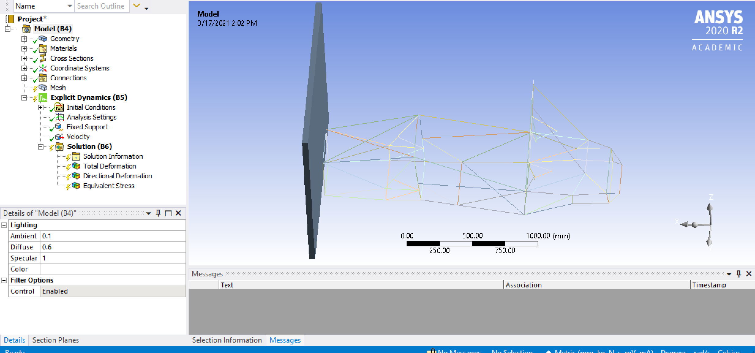

SubscriberHello, I'm trying to run a simulation, but the program isn't giving us a result.
Any thoughts on what could be wrong?Â
March 17, 2021 at 10:28 pmpeteroznewman
SubscribernYou don't have a mesh.nYou shouldn't have a velocity BC, what are you scoping that to and with what values?nYou should have an Initial Velocity in the Initial Conditions folder.nUnder the Analysis Settings, what is your End Time. Under the Output Controls, how many output results are you requesting?nYou have to hit the Solve button.nViewing 1 reply thread- The topic ‘Impact test’ is closed to new replies.
