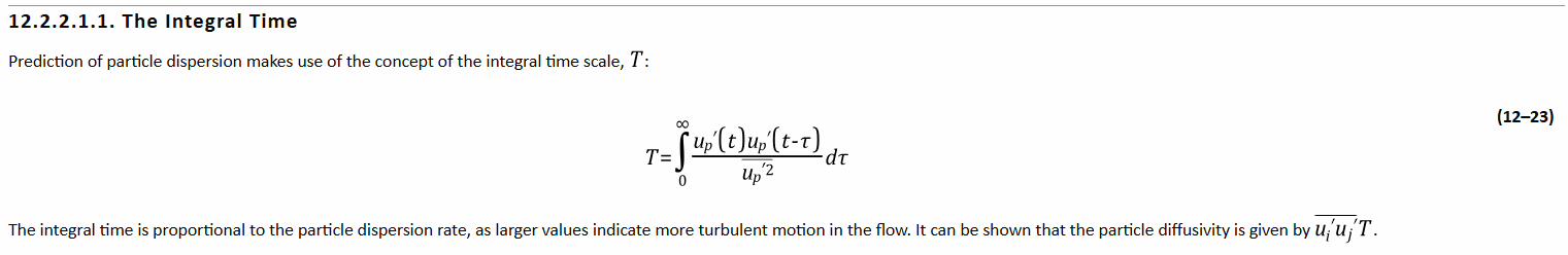

      • valentin.melot
        Thanks for answering. I can't put it to 10 since I use unsteady particle tracking. Anyway, I have a question regarding the Discrete Random Walk model. In the screenshot below, Fluent defines the integral time scale T, and it depends on the fluctuating component of the particle velocity (u'_p). How is the latter computed? Since u_p is found by solving the ODE of dx_p/dt = u_p and the force balance on the particle, how is there a fluctuating component? I'm trying to describe clearly the model, and especially why the number of tries is fixed to 1 for unsteady particle tracking.
