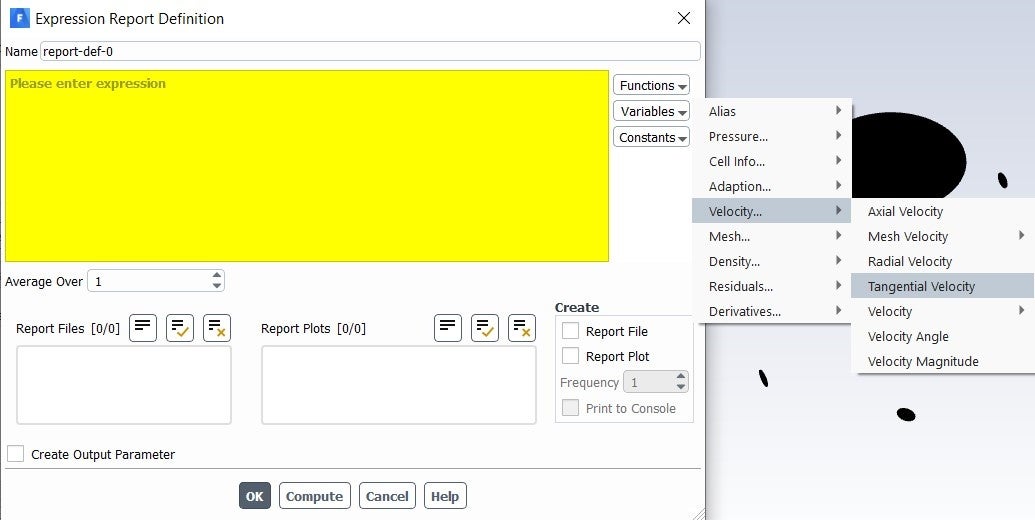

      Plz help me just to make this expression. I cannot use excel due to some limitations and honestly i couldn't understand the alternative u told.
      The thing is that i need to make an expression depending on y coordinate as x and z are constants ..
      Tangential velocity is available in velocity menu but it'll not give one constant value for each line while i need a constant value for each line for normalization. So i will set coordinates to get that particular value for normalization.
      Can u plz guide me in a little detail.

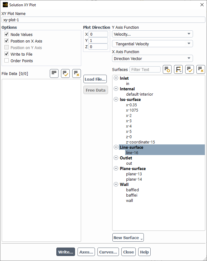

      Extracting tangential velocity with y-coordinate on a line in Fluent using an xy plot gets you the bulk of the data. The last point of the line may be the wall so that's that sorted. If you write out the plot you'll get a text file. This can either be used in Excel or you can also read xy plot files back into the Fluent xy plot panel.
      To add. Once you've written out the files you can read them in again via the Load option. Note, manipulating the data may need a Custom Field Function or (easier) Excel or the like.

      so i think an expression tangential velocity at (1,y,1) can solve the situation. for each line drawn the y has one value so there won't be a bulk of data . we will get a single value for each line .. i want it to be a function so that it can adjust itself as i will have total 10 lines and thus 10 different y values. x and z coordinates are same for whole problem so thats not a problem.
      so kindly guide me how can i enter this
      in expression. i get the tangential velocity under the velocity tab but i don't understand how i can fix the coordinates.
      Plotting expressions isn't available at present. So, you will need a Custom Field Function of tangential velocity / constant for each position. There is no function to do this automatically as we tend to want raw data from Fluent: if you want to manipulate data it's done externally. The xy files are human readable so in theory you can use a calculator & text editor.
      In Fluent, if you open the panel I posted you can create a plot. When you create the plot you pick a line/surface, this is something you create using Display-Surface-New choose line and follow the prompts in the panel. You'll need 10 of these. You can write out the plot (the text file) and once you have a few you can also Load those files back in to plot.
      If you click on Help you'll find tutorials. I think the NACA airfoils use xy plots on the wing surfaces and that'll give you a starting point.

      In report definition, we can define an expression. The tangential velocity is available under velocity tab i want to define an expression that says
      Tangential Velocity at coordinates (1 ,y ,1)
      Is this possible. If Yes then how ....
      Thanks in anticipation
      You don't. You plot the report at a position using a surface as I mentioned. In your case it'll be a line from the axis to the wall: the XY Plot image is what you're replicating.
