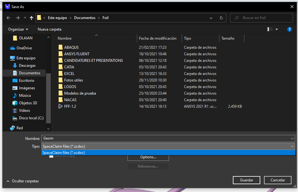

    • deandres
      Hello @peteroznewman i've had the same porblem as AkashVyas, and i don't know how to solve it, here you have a screenshot of what i see when i try to save my document into *step in the spaceclaim
      deandres
      ANSYS decided to remove the ability to export any file types from SpaceClaim in the recent releases. Read this discussion:
      The only workaround, which will only work until 1/31/2022, is to download and install ANSYS Student 2020 R2.
