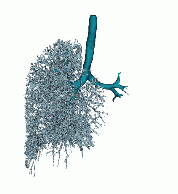

SubscriberI'm using the watertight workflow and I've already created the superficial mesh. But now I'm getting error messages when creating the volume mesh.
The error is: Error: 0 : Please fix the overlaps along multi-connections and try again.Error Object: #f
September 20, 2021 at 1:05 pmKarthik Remella
AdministratorHello The watertight workflow is for Clean Watertight geometries only. I'm assuming that your geometry was created in an external tool (perhaps, CT scans - just a guess). If your geometry file isn't clean, you might not be able to create a good mesh using this workflow. You might want to look into the Fault Tolerant Workflow, which was created primarily for CAD files with issues (or errors).
