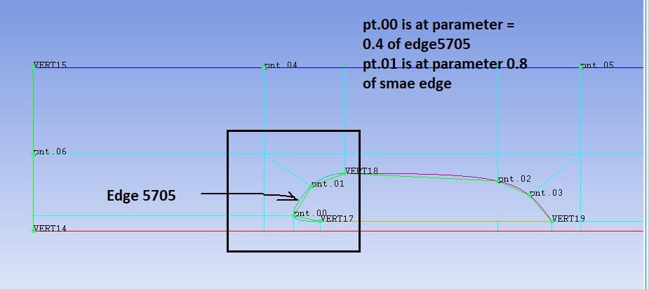

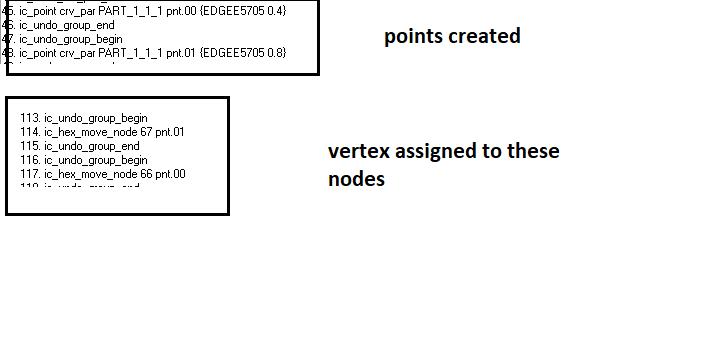

I am creating a script for meshing in ICEM CFD for parametric study.
I want a point on the curve which is at a parameter of 0.4 and 0.8 on the curve. I create this point (In script editor these points are point pt.00 and pt.01) [image 1 and image 2] I then assign vertex ( vertex/node 67 and vertex/node 66) [image 2] to these points respectively. Now when I change the curve dimension (for optimization) and update ICEM CFD the points defined by parameter 0.4 and 0.8 are created but their names are changed on update (pt 04 and pt 05) [image 3]. The problem is that in the script the vertices were assigned to pt.00 and pt.01 and As a result, ICEM CFD throws an errorÂ

Ansys EmployeeHi Anup:
ICEM will name points sequentially as each new version of the geometry comes in. In the second instance, since you already have points 0,1,2,3, points 4,5,6,7 will be created. A crude fix would be to have a command that just forces the names back one step each time.
For instance, the first time through, there will be no points 4,5,6,7, but you can still issue commands to rename these to 0,1,2,3 (ICEM should just issue a warning that the points to be renamed couldn't be found)
On subseqent passes, point numbers will be bumped up to 4,5,6,7, so the command:
ic_geo_set_name point pnt.04 pnt.01 1 0Â etc ...
should rename them to the originals and then the script could proceed as usual.
