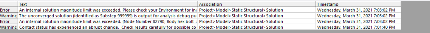

TAGGED: static-structural
March 31, 2021 at 5:54 pm
ahlamosama
SubscriberApril 5, 2021 at 5:11 am1shan
Ansys Employee,nThis might happen if the structure is unconstrained or if any contacts are open. Please insert a contact tool to check the status of each contact. You might run a modal analysis with frictional contact suppressed to see if model is adequately constrained.nnRegards,nIshan.n nViewing 1 reply thread- The topic ‘I would solve this model nonlinear but i face some problem can any one help me,please .’ is closed to new replies.
