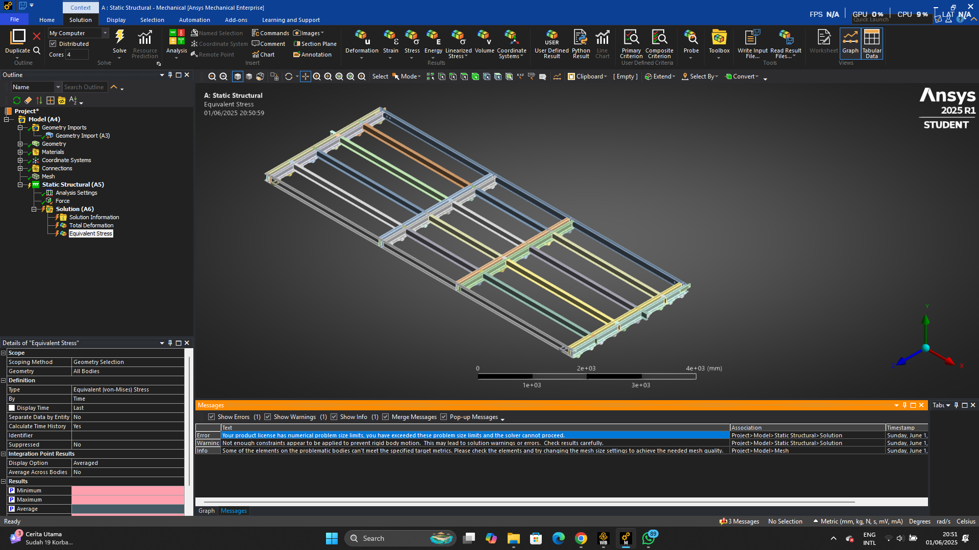

i unable to run the analysis
    • nandaputra
      why i cant running my analysis since my geometry files was able to fully meshed, but i still unable to finish my analysis since its always end up like this. and has those kind of messages. may i get some help to solved this kind issues ?
      thankyou.
    • Shashidhar Reddy
      This kind of error usually appears if the license has "number of elements/nodes" limit like Academic license. But looks like you are using Mechanical Enterprise license.
      Can you please check by reducing the mesh? I mean number of eleemnts.
      Also, can you please show me if you are having warning in "solution information" (solver out file)?
      Regards
