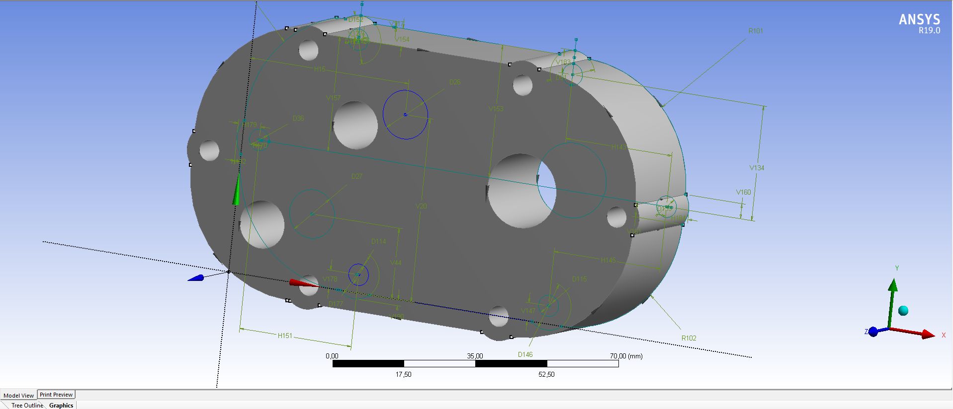

       So I did it by misake, but I do not know how to change it again and I described it before. However now I realized that I am not capable of doing extrude normally, because I am not able to give the sw. a value of thickness e. g. You can see in the model, that I am not able to put the sw a value of casting value of  6 mm, but it takes 25 mm. How to set it up back. Please see that I am not able to access to the details of extrude where you can see at 35 seconds of this view:

      Here, you can see at the object the thickness it to be only 6 mm, but by the Ansys 19.0 it takes 25 mm thickness.

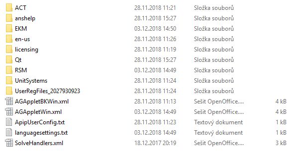

      So I found the C:UsersgeorgAppDataRoamingAnsysv190 and what to find later on and what to change? Thanks
    • Georgiro
      So to see the directories in v190 as shown below, what shall I do?
    • Georgiro
      Or shall I delete all the data that are there?
    • Georgiro
      I have deleted it and it works perfectly, so thank a lot, this was perfect!
