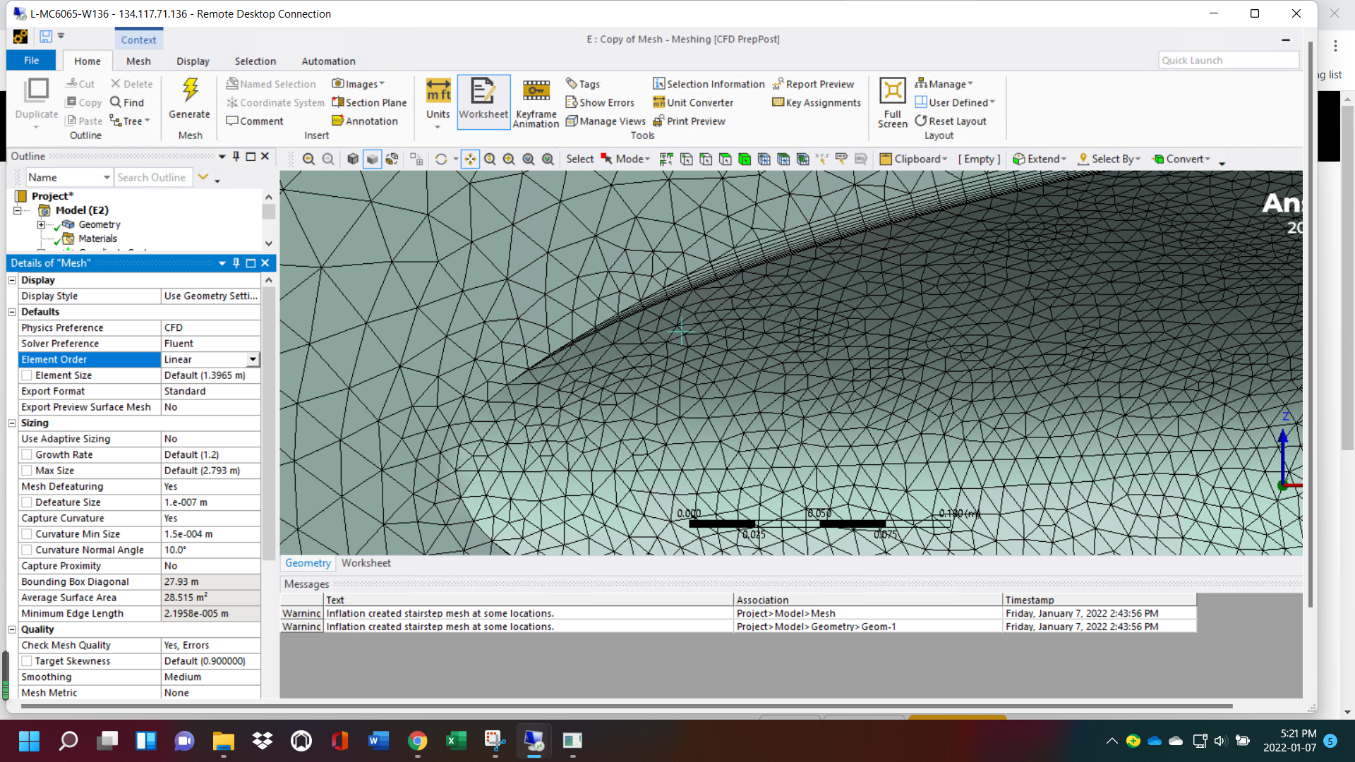

SubscriberI am using the the 2021 version of ANSYS workbench and here is my mesh data:

SubscriberI tried reducing the number of layer, increasing the mesh growth ratio, and CFD mesh doesn't have the orthogonal value.

January 14, 2022 at 9:19 pmmaxning
SubscriberI tried, but stairstepping is still here
January 17, 2022 at 5:04 amKeyur Kanade
Ansys EmployeePost zoomed in images of the geometry at that location.
