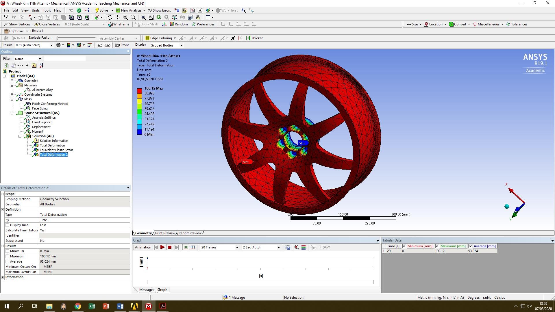

      Hello Everyone,

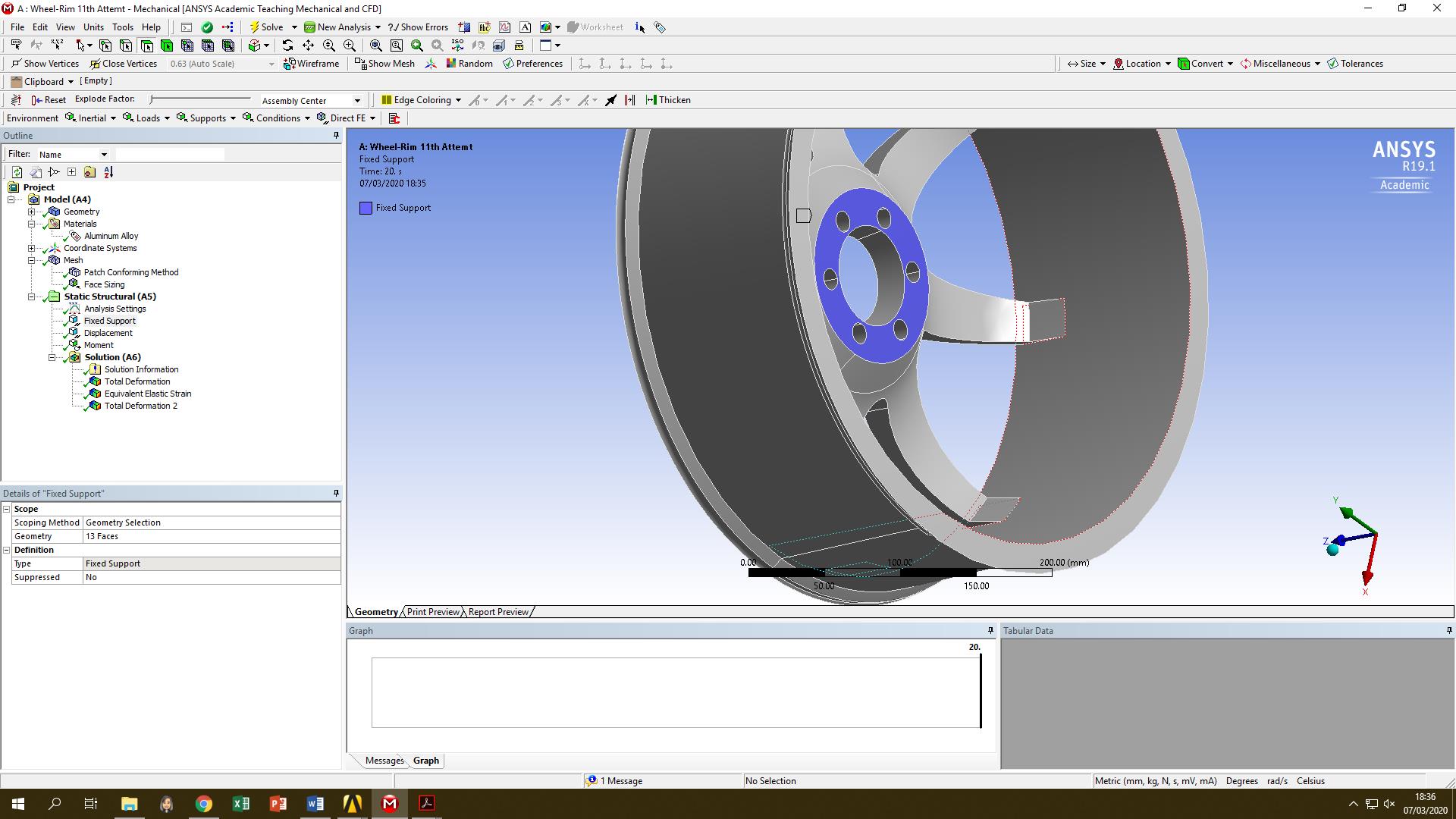

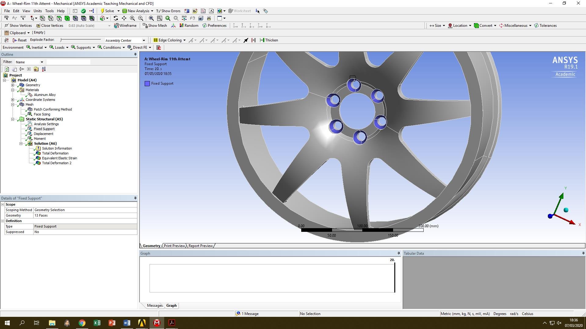

      I have created the Wheel Rim in Creo 3.0, I need a bit of help on determining and making sure the total deformation is low to continue later to topology optimize it. I am unable to go to the next stage as the stress are very high, is anyone able to help me with this problem. I am not sure if I have applied the fixed support in the right place
      Total deformation of the Wheel Rim
      The Fixed Supports are fine.
      1) Under Analysis Settings, turn on Large Deflection. This should reduce the magnitude of the Deformation.
      2) A small angular deformation in the spokes allows a transverse motion of the rim, which is a rigid body motion.  It is more meaningful to plot stress and strain.
