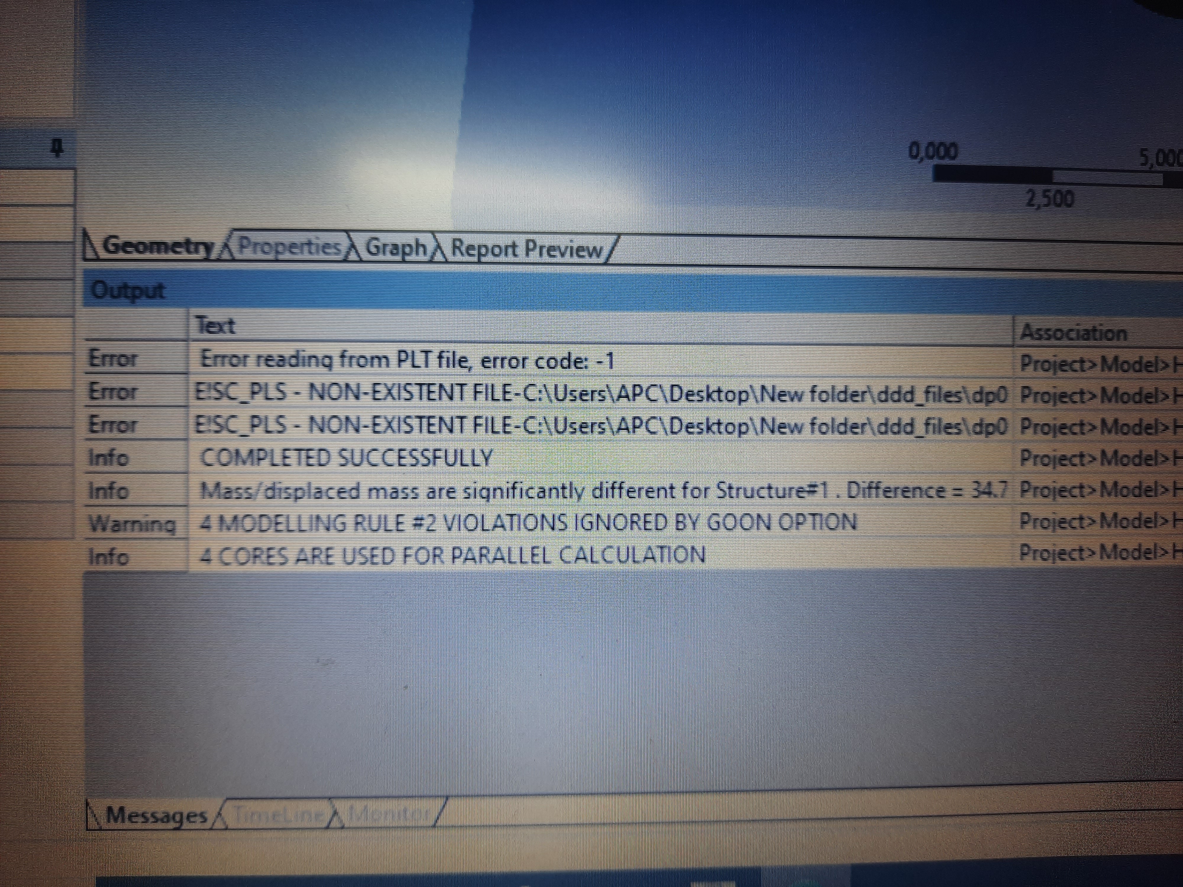

SubscriberJanuary 25, 2022 at 2:21 pmMike Pettit
Ansys EmployeeThis is a known issue which has affected all Aqwa releases since 1st Jan 2022. Please refer to the workaround provided here: PLT file when using WORKBENCH AQWA ÔÇö Ansys Learning Forum
There is also a Solution available via the Ansys Customer Portal: #2067087 - I can neither generate any graph display in the Ansys Workbench Aqwa editor nor can I plot any graph in the Aqwa GS (AGS) application. Why is this?
Please let me know if you have any problems applying these solutions.
Mike
