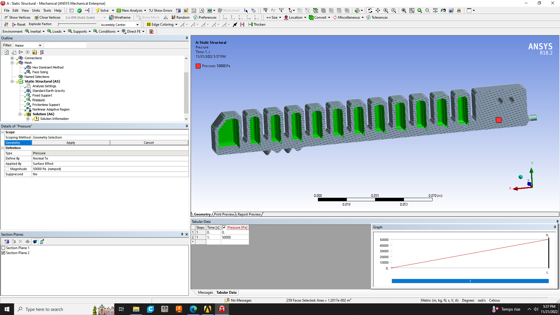

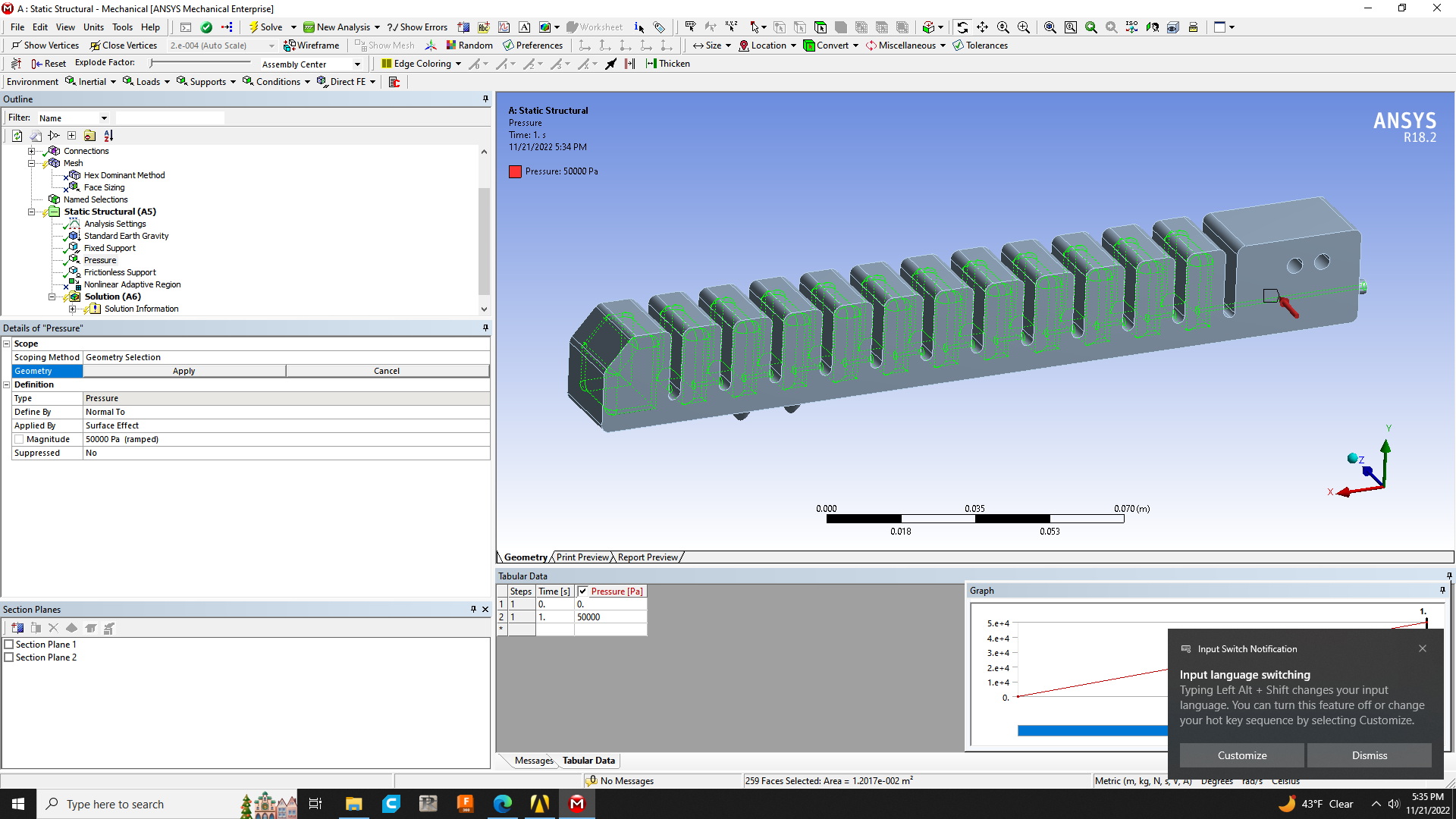

      I have been trying to simulate a hyperelastic model made from DragonSKin 10 with the following properties being put in Ansys:
      Odgen 3rd order model with parameters taken from the research paper
      Mesh sizing of 0.001m
      Quadratic Non linear mechanical model
      1 Fixed Support from where I am inducing pressure
      2 frictional support to prevent normal movement from the sides
      Pressure of 50000Pa
      Analysis settings set as Programmed controlled autostepping with total 3 steps and minimum step size as 0.001

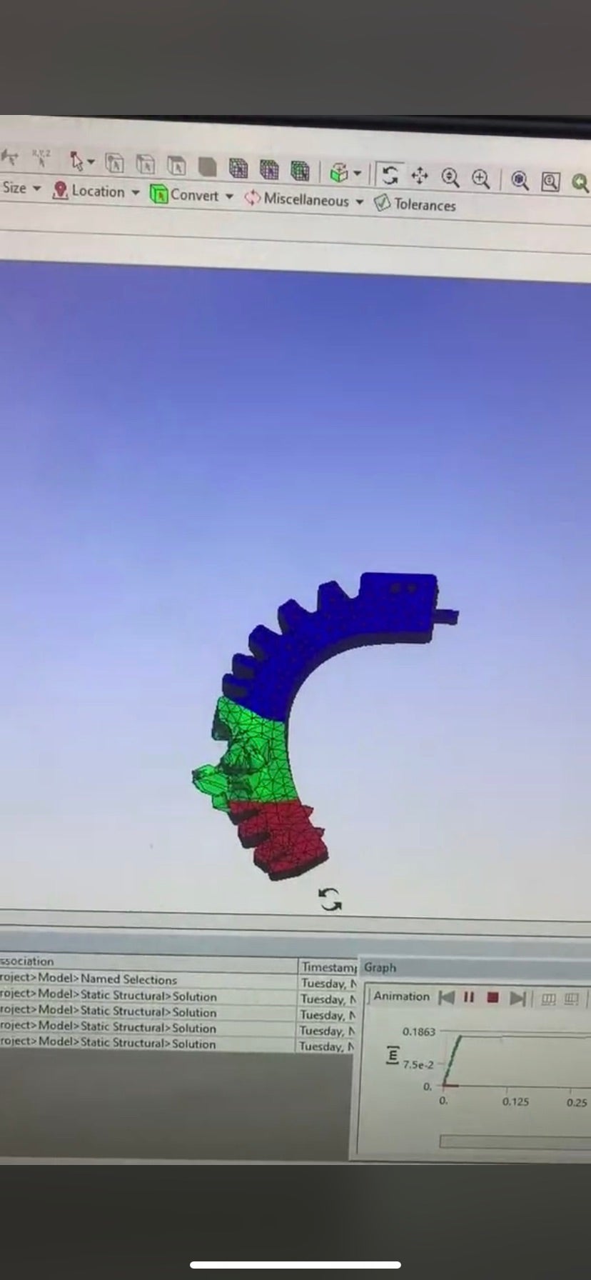

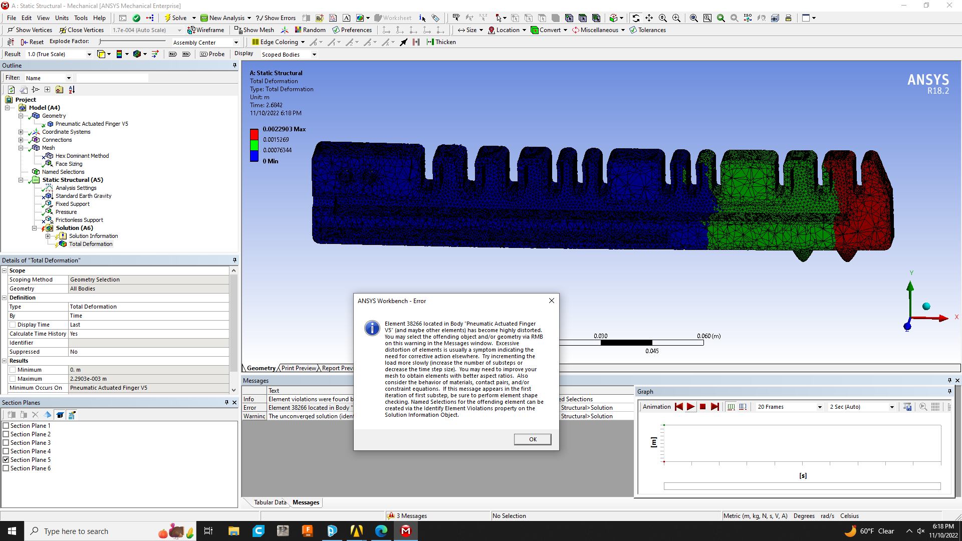

      This is the screenshot of my present status. I am not sure what I am doing wrong in the simulation. It is not bending enough. I want to make sure if I have done everything correct in the simulation.
      Kindly refer to Nov 9 comment for the parameters I have set.

      For technical support, you should have TECS: Technical Enhancements and Customer Support (TECS) | Ansys
      The error is element distortion. Try using a finer linear mesh. You can start iterations with a coarser mesh and then try to refine the mesh.
      Define substeps/ timestep size for each step. This will help you to increment the load slowly. Also, please check in which step are you experiencing this issue.

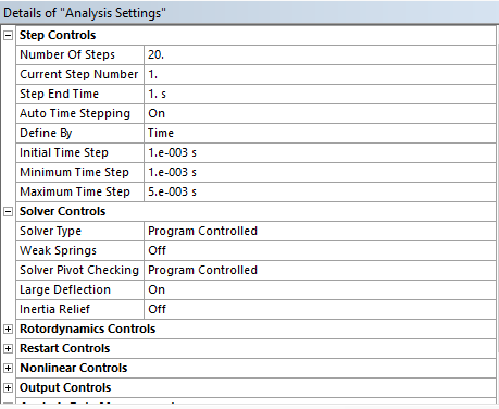

      So, it does not matter if you use time or substeps.  Also, steps are to break the load conveniently for loading purposes, and substeps is used to break that step into smaller substeps. You do not need 20 steps. You just need 1 if you wish all loads to ramp up over that first step.  Do make sure your pressure is ramping from zero at time zero to max at time = 1.0 (end of load step 1)
      I would start with 200 substeps, min 10, max 2000.
      In meshing, I would set the physics preference to nonlinear mechanical. One of the biggest issues is the elements are poorly shaped to begin with, so a little bit of deformation and they become ill-shaped  and the solver can not solve with them.
      You may wish to try a more uniform mesh, but turning off adaptive sizing.

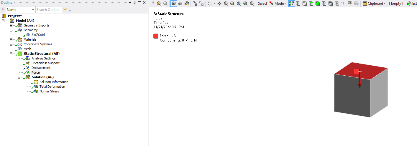

      Have you tried just testing the stability of the material?  You can take a cube of the material and deform it in various modes of deformation to see that it is behaving numerically stable. This is helpful to debug material model issues.
      I have seen users put values from papers into Ansys in wrong units, so please double-check this.
      Also before you run, you go to Analysis Settings> Identify Element Violations and set to 1.  After you run the model and it does not solve, under solution information, it will have some objects that indicate which elements are becoming highly distorted. You can share images of the elements and where they are located.  By improving the mesh, you can sometimes go further.
      If the deformations expected are very large, then the model may need to use nonlinear adaptive remeshing (NLAD).
      Please try these recommendations first. Thank you!

      Each step has a time associated. For example a model with 2 steps, step 1 can have a time of 1.0 sec and step 2 can have a time of 1.0 sec and the total time of the simulation will be 2.0.  But for static analyses, time is only a marker. It has no physical significance. So let's ignore time, and just stick with substeps. Since you have just 1 load, run it in one step.  At end of simulation you get to 1.0, model is has all the load applied.
      Max substeps of 200 may not be enough. When the convergence is difficult, it can need more.  Set to 1000 or 2000.

      By material stability, take a block and try to deform it in some standard modes of deformation. Tension, compression, shear.  Put boundary conditions so the block is uniformly loaded.  It is like a single element test of the material.  If you can't get larger strains that you expect from the material curve fitting with simple geometry, then the material calibration (curve fitting) may be the problem.  We want to isolate if it is material related or mesh related.  My prior comments above assume that material is not the problem (meaning the curve fits produce stable material response and behaviors).

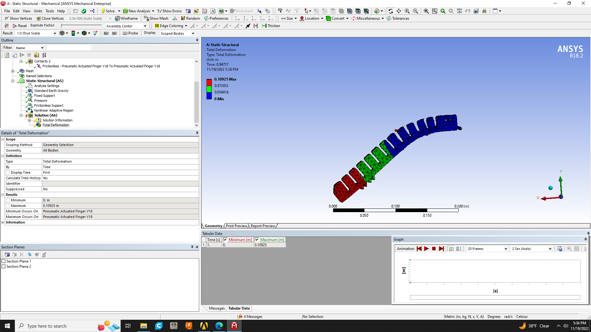

      I used uniform meshing and number of steps to 1. Minimum substeps: 200 and maximum to 2000.
      I am trying to understand why the front part of the finger is not bending further. Any ideas? I want a full finger like curl.

      I think this is process, at least getting further than before. So with time=.94 and if end time is 1.0 you have 94% of the pressure applied. Can you highlight the loading on the model?  Where is the pressure applied?  Also, can you highlight where you have contact in the model. Also double check the material assignment is correct under the parts in geometry.  Just in case it was not.  I don't think this is the issue but just a basic check. Thanks.
      Btw,  does the curve fitting match the material test data? Can you share plots of the fits and which hyper elastic material model you are using.

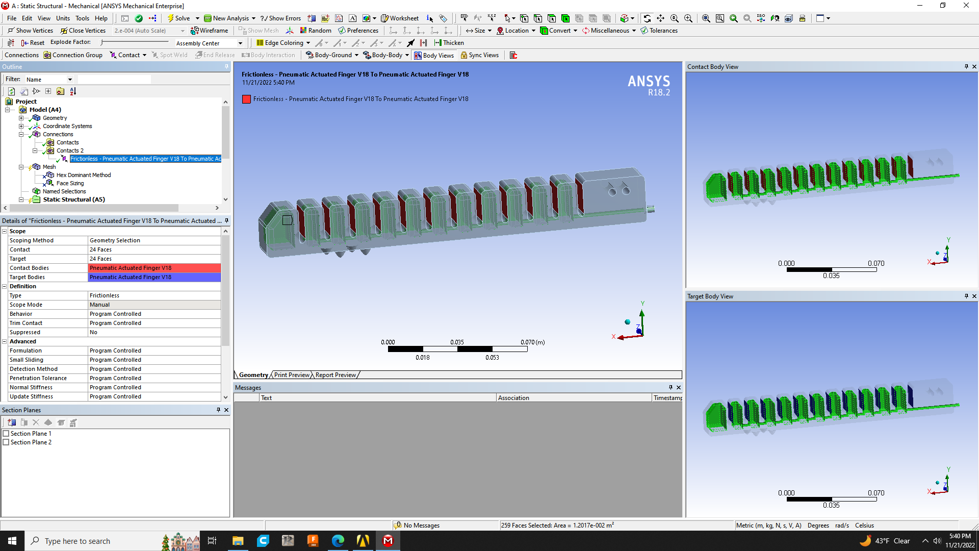

      Contacts are basically the inner faces which might come in contact if they expand to the limit.

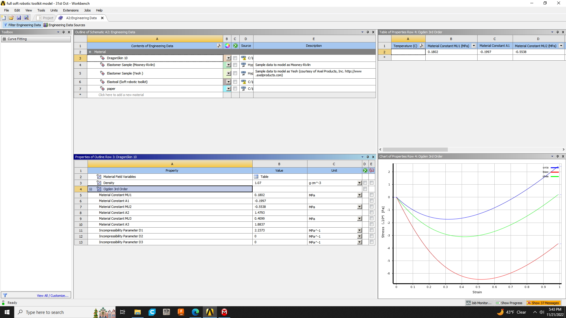

      Here there are multiple materials that I was trying with but from these I used dragonskin 10 variables from the research paper.

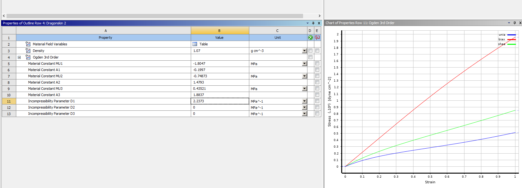

      Thank you for sharing.  So the material curves you provided. Do they make physical sense to you?  For example, a uniaxial tensile test that has a negative slope means that if I push to material into compression, it will stretch.  In other words, negative stress, gives a positive strain.
      It seems this material is a type of silicone right?  Would you expect this behavior?  Did the paper you get this from have the stress-strain curves to verify against?  Also, there are some hyperleastic material models that even though are the same name, the implementation is a bit different.  For example, in Ansys and Abaqus, there can be a difference in the implementation even though the coefficients seem to be the same symbols.
      Can you share your material reference, or elaborate?  Thank you.

      I modeled your material using those constants on a simple cube.
      I push into the cube, so what should we see in the simulation?  You expect it would squish down right?  But look what it does.  The cube stretched.  This is non-physical for the silicone material.
      Look at the paper you provided and we see the stress - stretch behavior.
      Details are in the caption following the image
      But look at the curves in the engineering data.  They show a negative relationship between stress and strain.
      This is where your problem lies.  You have the incorrect material response.

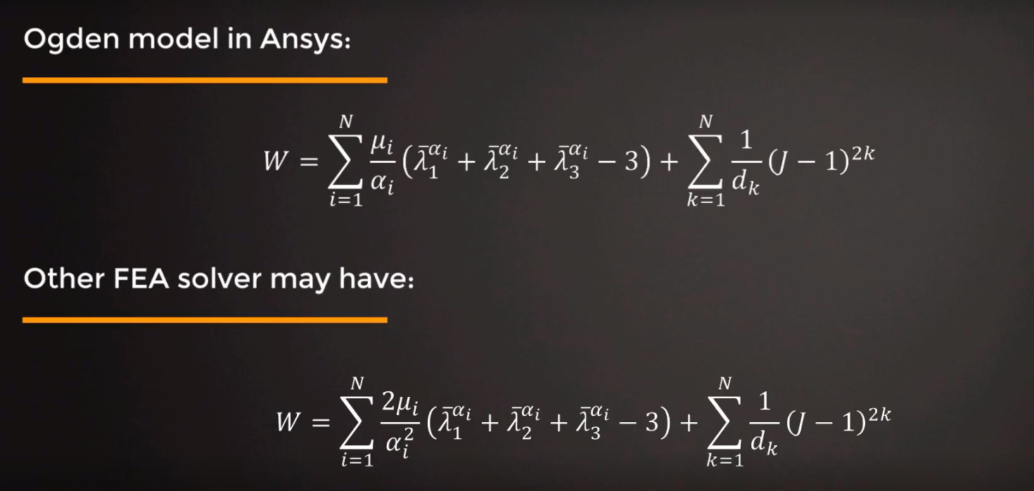

      Now you may ask why?  Is it the units or typo?  While that is a common error, it is related to the slide below.
      The Ogden model in Ansys has a slightly different construct using the variable. That paper has the constants for Abaqus.  The equations are identical, only that what is that mu is different.  To compute mu in Ansys, set the first term ui/ai = 2ui'/ai   Let ui' be the value from Abaqus, now you solve for ui (which is mu for Ansys) and you will get ui = 2ui'/ai.

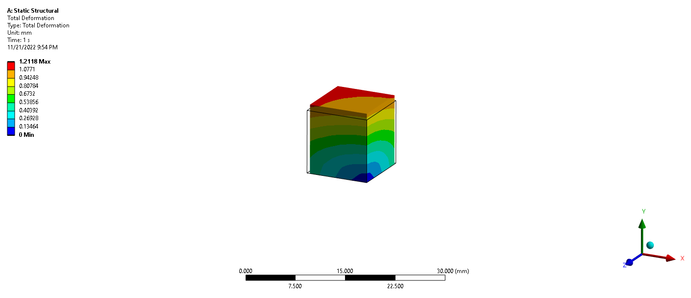

      I have done this and this is the modified material data
      Notice with positive stress we have positive stretch (strain).  This is physical behavior for the silicone material.
      Alternatively, you can input the material data provided from the charts, being very careful to convert to engineering stress and strain, not true stress and stretch. Then you would curve fit using the curve fit tools in engineering data. My colleague already provided lessons on how to do that.
      I suggest you try the values I have provided to see if you start to get physical behavior.  I leave it to you to double-check my inputs.
      I also suggest you take the hyperelastic free course which would have helped you identify that you have a non-physical stress-strain response.  But the mistake you have here is an easy one to make. It can be easily assumed that if Ansys and Abaqus have Ogden, then the mu and alpha are the same.  Unfortunately, the forms are slightly different.  Now you know :)
      Please circle back and let me know if you start to get the actuator to deform more as expected.

      Hi Sean! It works perfectly now! I will send a screenshot shortly.
