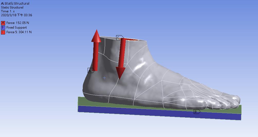

      my boundary condition setting
      boundary condiction

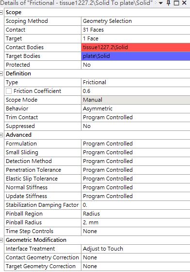

      my contact condition setting

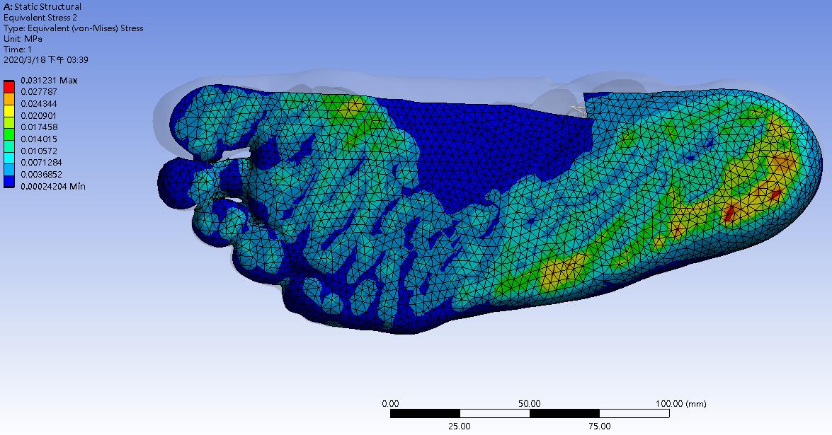

      my simulate result

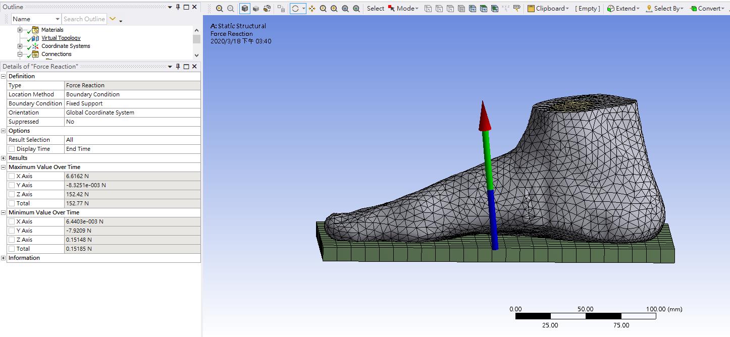

      reaction force
    • SaiD
      Can you explain the boundary conditions? Why is there an upward force of 152.05 N (Boundary condition A)?
      From the results, it looks like the reaction force is balancing out the applied forces, so that seems fine.

      The upward force 152.05N is Achilles tendon force.
      I refer to the method of other papers, as shown below.

      Interesting model! Looks like you got your boundary conditions set up correctly.
      So for a 60Kg person, the reaction force on one foot is about 290N (compared to yours 190N), and your contact area looks slightly larger than a normal person's. What material property do you use for the muscle? Maybe tweaking your material properties (like makes it harder) and see how the result will change?

      My contact conditions face are set as shown below.
      My soft tissue was considered nonlinearly hyperelastic(the second order polynomial model).
      I have made soft tissue harder two times, but the plantar pressure only increased by 11.7%.
