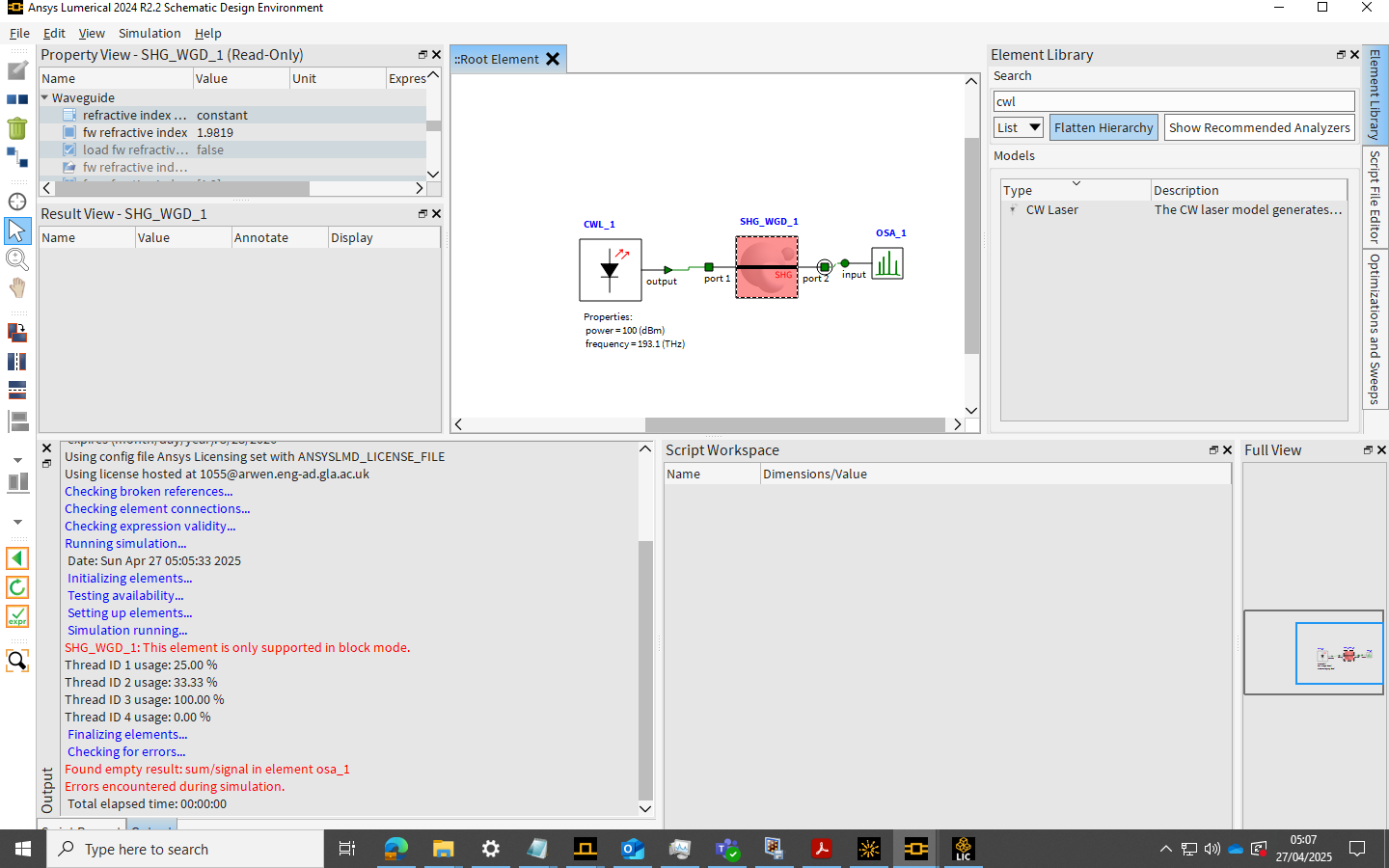

      • d.kelly.2
        I also can't seem to be able to get the element to output any signal. I've connected the default CWL like you said, set the OSA sensitivity to 0W, but the simulation only outputs an empty result. I've tried increasing input power from 0, but still to no avail. Thanks!
