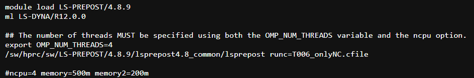

        When we tried to run in the cluster, there is no kfile created and the error jumped out several similar lines as following:
        (process:103941): Gdk-CRITICAL **: 00:12:55.741: IA__gdk_screen_get_width: assertion 'GDK_IS_SCREEN (screen)' failed
        (process:103941): GLib-GObject-WARNING **: 00:12:55.745: invalid (NULL) pointer instance
        (process:103941): GLib-GObject-CRITICAL **: 00:12:55.745: g_signal_connect_data: assertion 'G_TYPE_CHECK_INSTANCE (instance)' failed
        However, we just tried to run in LSPP GUI in the local computer, and found it successfully created the part.
        We need to run lsopt in the cluster, so creating parts also needs to be done in the cluster. Is this issue caused by the the command in run file or is anywhere in cfile should be editted for running in the cluster? The following figure is our command in runfile.
      • cct
        I also tried using the same version of LSPP to create the cfile as what we use in cluster (4.8.24), but it still has the same issue (shown in the following figure).

      You can try couple of things:
      1. Use '/path/lspp48 -nographics c=' command instead of '/path/lspp48 runc='
      2. Don't use slurm script to submit LSPP job. In LS-OPT stage solver command, enter below command and turn on "do not add input file argument".
      /sw/hprc/...../lspp48 -nographics c=LsPrepostOpt.inp

        With way 1, we got the error : Unable to initialize gtk, is DISPLAY set properly?
        With way 2, we found in stage1 (LSPP)/1.1, the parameter is read correctly, but kfile is not created. And the same error message is shown in stdout file.

          Try option 2 using a newer version (v4.9) or newer build of 4.8 (4.8.22 is latest).
          Is the command correct? Why are you calling 'lsprepost' instead of 'lspp48' script located in /sw/hprc/sw/LS-PREPOST/4.8.9/lsprepost4.8_common? Try below command. Make sure "DN" variable in 'lspp48' script points to correct installation path.
          /sw/hprc/sw/LS-PREPOST/4.8.9/lsprepost4.8_common/lspp48 runc=
          Next try mesa version,
          /sw/hprc/sw/LS-PREPOST/4.8.9/lsprepost4.8_common/lspp48_mesa runc=
          If these don't help, I will have to check with LSPP experts.
        • cct
          The command was correct; I just wanted to specify that the stage 1 is the stage of LSPP but we just not named it LSPP. We used the directory "/sw/hprc/sw/LS-PREPOST/4.8.9/lsprepost4.8_common" in the command. Sorry for the confusion.
          The latest version we have in our cluster is 4.8.24 and I tried it with option 2, but they still cannot create the kfile.
        • igandiko
          What I meant is, in '/sw/hprc/sw/LS-PREPOST/4.8.9/lsprepost4.8_common' directory, 'lsprepost' is a binary but there is 'lspp48' script in the installation directory which set environment for some libraries before launching lsprepost. You should be calling this script to launch LSPP. Please check if 'lspp48' file is located in /sw/hprc/sw/LS-PREPOST/4.8.9/lsprepost4.8_common. If yes, make sure "DN" variable points to correct directory and then try below command,
        • cct
          Also, I just checked with our previos slurm script and found we used "/sw/hprc/sw/LS-PREPOST/4.8.9/lsprepost4.8_common/lsprepost runc=LsPrepostOpt.inp"
          In that case, both of running this script directly and run it in LSOPT work. Yet, both lspp48 and lsprepost do not work now.

      When running the LSOPT GUI, I put "/sw/hprc/sw/LS-PREPOST/4.8.24/lsprepost4.8_common/lspp48" in the command of Stage LSPP.
      I also rerun the LSPP with slurm script (edited the lspp48 from lsprepost), but it showed out the error message "Permission denied."
