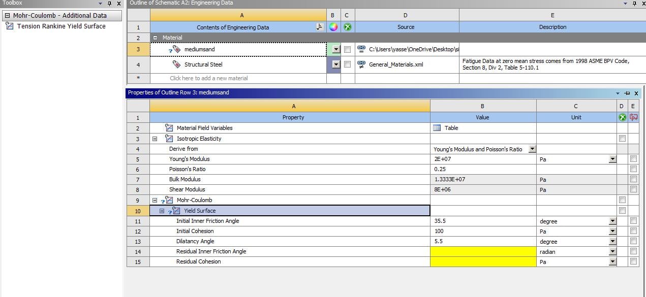

      Dear All
      i am trying to model a soil for single bucket foundation with  Mohr-coulomb failure criteria but unfortunately,when i define and insert the
      properties of the soil i am faced with this error when i refresh the project to introduce materials and i cannot find the defined materials to assign the project
      here it is my model description for  Mohr-coulomb
      i should mention when i delete the Mohr-coulomb from the project All the parameters goes well, i mean you can not get enough and precise solution even with warnings but at least works and this sign(red multiplication )will never show up
      for my project, i need to define the soil with Mohr-coulomb failure criteria but  actually, i do not know how to overcome these errors and problems
      please if someone has any idea or has already modeled a soil in ansys help me in this case
      Best regards
      Yasser
    • jj77
      You just need to define the values in the yellow areas as you show in your image above. As I am using other software for soils, I am not sure what values, to enter there, but I am sure you can find out values for sand that you are using. Perhaps setting the residual values (cohesion, friction angle), to half of the initial one is a start.

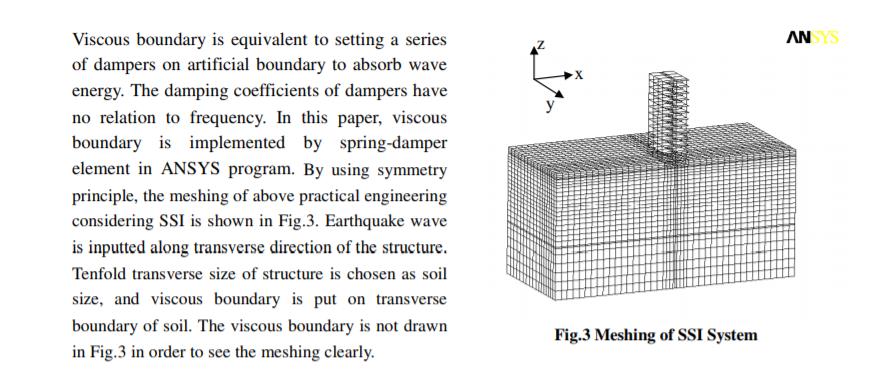

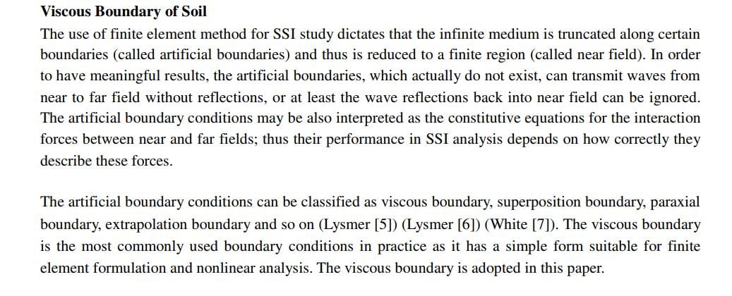

    • yasser1987
      Dear All
      i have found a paper that describes how to model a soil with mohr coulomb  and its Boundary condition, but i cannot understand how to apply this kind of boundary condition to my model in Ansys, i mean which options and icons must be used in order to apply the BC and etc
      could you please help and guide me to apply the BC to my model?
      Regards
