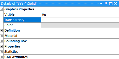

      Im using Ansys 2024. Whenever I try to open Mechanical or Mesh from workbench the bodies get transparent by default. How to change to opaque again?

      You can try following option:
      1. Open Mechanical > Geometry > Graphics Properties > Transparency
      2. Set Transparency to 1.
