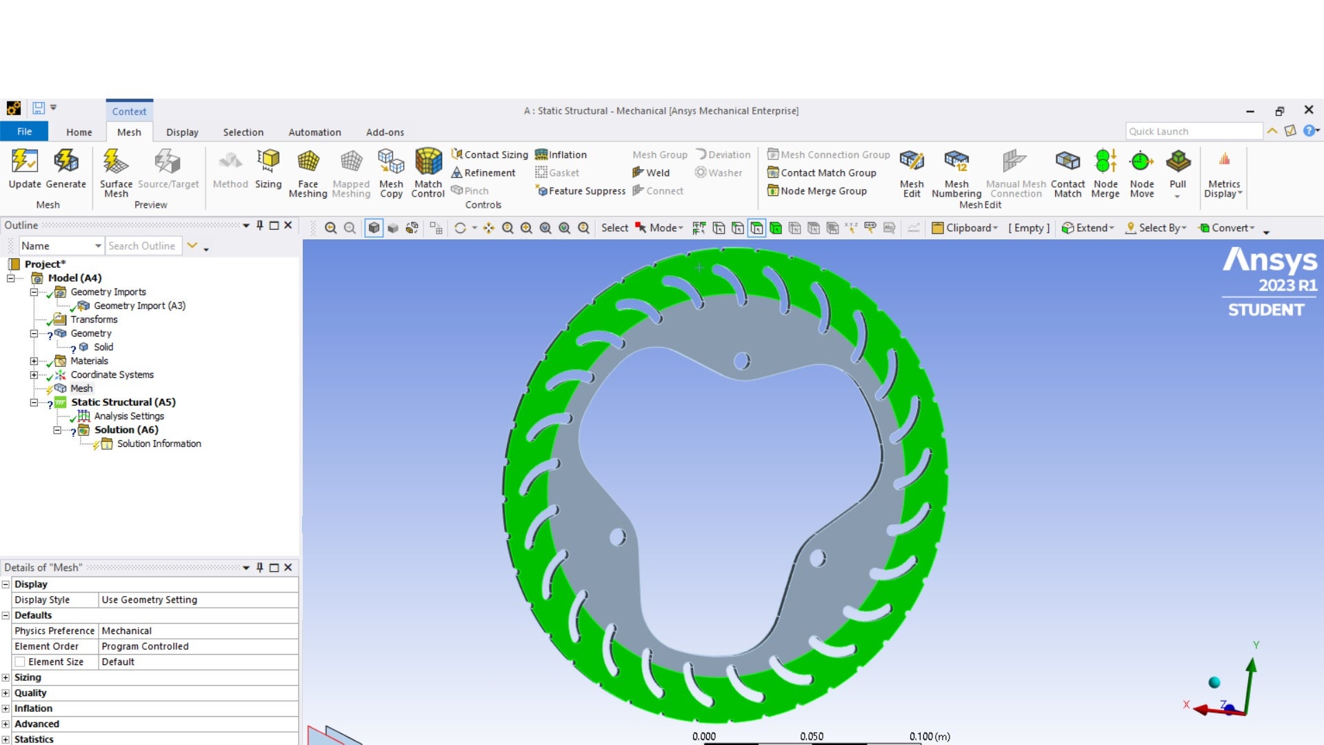

      My goal is to have multiple elements along the thickness of the disk to properly simulate bending stress. I've split the face so I can apply a Pressure boundary condition only where the brake pad sweeps the rotor face (highlighted in green). However, this seems to make the body unsweepable and I'm curious if there's a workaround or perhaps a method similar to Sweep that will allow me to have 3 or 4 elements along the disc thickness.

      You will need to decompose it further. Please check following video on hex meshing.
      Please check following videos
      Ansys Meshing: Decomposition for hex meshing:
      https://www.youtube.com/watch?v=P19GOTQWmc0
      Ansys Meshing: Meshing Methods:
      https://www.youtube.com/watch?v=nEOC8rDnnRo
