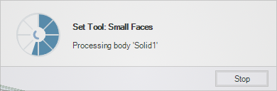

SubscriberWhen Spaceclaim gets stuck in a spinning blue cursor circle and there is no stop sign availble to press at the bottom and tapping or holding down esc does not work. Is there a way to stop it without losing your work? I know it saves periodically but I can not see when it last saved. The last resort is to open task manager and shut it down.
This just happened when I tried to remove a face on a solid.

Forum ModeratorHello Richard Beck The ESC key or hitting the STOP button as shown in image 1 below, it throws a pop up as shown in image 2.
You can click 'Stop' to terminate the process. But this works when SpaceClaim has not hanged. Once it's hanged it may be at a point too far to stop the operation because the program has stopped responding. Typically, if ESC doesn't work, it will be hard to recover.

SubscriberThanks, so if it really locks up then only option is to close it via the task manager and reopen and restore.
