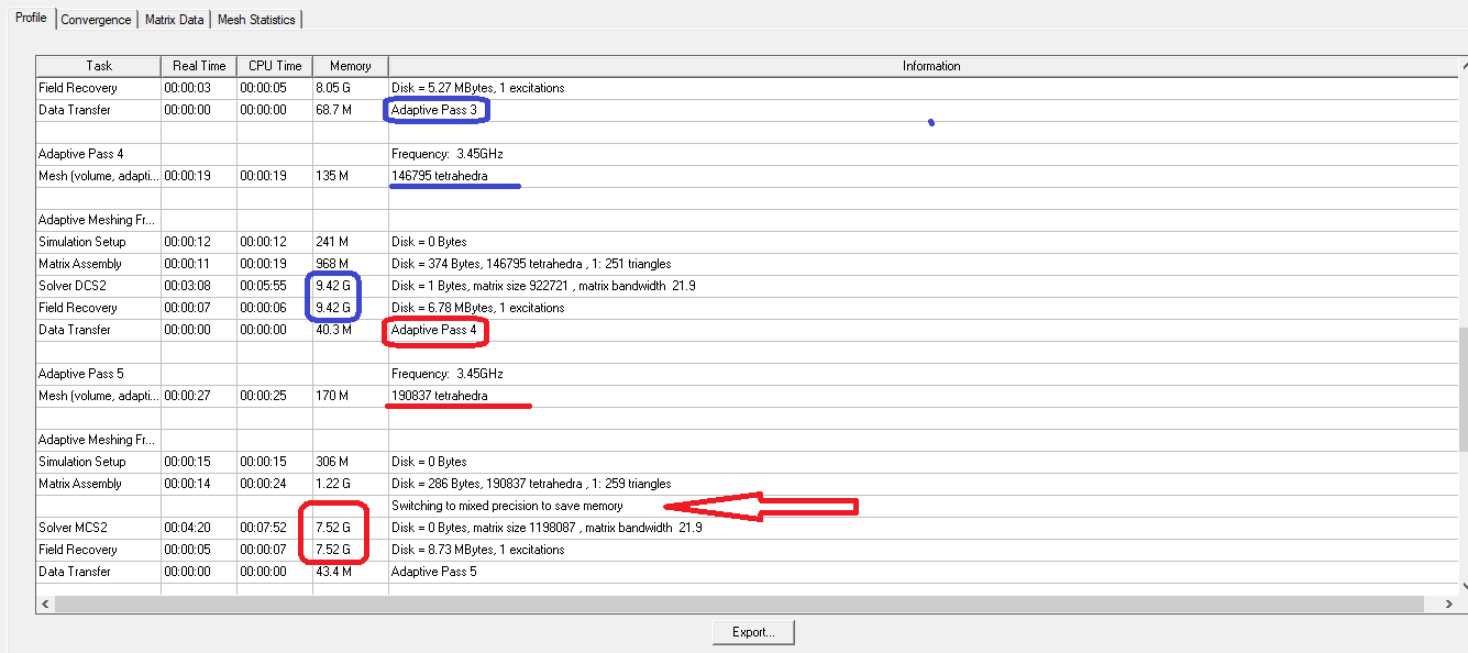

      I am simulating the same structure using two different PC to check if the results are same. The two PCs are: a laptop with 12GB RAM, and a desktop with 32GB RAM. I noticed, in desktop, it takes ~ 19 -20GB memory to solve 6 adaptive passes of the structure at 3.55GHz. However, in laptop, it takes only ~9 GB memory to solve 6 adaptive passes of the same structure at 3.55GHz. The results are also not same.
      I found from the 'results -- solution data -- profile' that, in laptop it is 'switching to mixed precision to save memory' after adaptive pass 3. So, it takes less memory to complete adaptive pass 4 than that to complete adaptive pass 3 , even though the number of tetrahedra is higher at adaptive pass 4.
      So, I was wondering why is this feature 'switching to mixed precision to save memory' getting enabled? How to stop it? How much reliable is the result that is obtained from solving almost similar numbers of tetrahedra of the same structure with less memory?

      Hello @ fparveen As You mentioned, you are using two different machines, Could you please tell us the processors and other hardware configurations were the same for both machines?
      HFSS uses adaptive meshing.
      If you are simulation the same model you should get the same results irrespective of the RAM and CPU. It seems switching to mixed Precision is due to your laptop have NVIDIA graphics card.
      Using less memory does not mean the end result is less accurate, if the solution is converged completely that means results are accurate.

      When playing with basic dielectric substrates, I found that the model computed with Nvidia, indeed, requires less memory. I did not find serious troubles with the solution, except Nvidia RTX 5000 which I used is blazingly fast.
      ...And yes, AFAIK RTX cards are better in mixed precision than GTX, because they can use different cores (different precision) simultaneously, which older GTX cards can not. Or how it is explained in gaming industry. I am not very familiar about hardware details.

      May I know what does it mean by "mixed precision"?
      Laptop: Intel Core-i5-6200U CPU @2.30 GHz, 2 cores, 12GB RAM
      Desktop: Intel Xeon CPU E5-1603 @2.80 GHz, 4 cores, 32 GB RAM
      My Laptop has an intel HD Graphics 520 installed, Desktop doesn't have any graphics card. But I now see that desktop also switches to mixed precision, when I set the RAM limit to 25%.

      Hello I figured out the difference in the results was due to poor convergence. I took two more adaptive passes, and then the results match quite closely for both cases (with and without switching to mixed precision) .
      Thanks for the comments and help.
