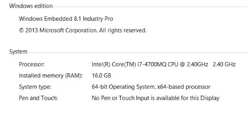

Subscriber-- Hi, I am getting the following errors. I would like to know the causes of this errors and How can I solve it.Â
 *** ERROR ***   SUPPRESSED MESSAGE  CP = 124689.453  TIME= 18:01:55
 An unexpected error ( SIG$SEGV ) has occurred...ANSYS internal data has been corrupted. ANSYS is unable to recover and will terminate. Previously saved files are unaffected. Please send the data leading  to this operation to your technical support provider, as this will allow ANSYS, Inc to improve the program.              Â
 *** WARNING ***  SUPPRESSED MESSAGE  CP = 124692.969  TIME= 18:02:25
 During this session the elapsed time exceeds the CPU time by 63%.  Often this indicates either a lack of physical memory (RAM) required to efficiently handle this simulation or it indicates a particularly slow hard drive configuration. This simulation can be expected to run   faster on identical hardware if additional RAM or a faster hard drive configuration is made available. For more details, please see the  ANSYS Performance Guide which is part of the ANSYS Help system. Â
--If you need any additional information please informed me.
--The characteristics of the PC is in the following image :

SubscriberThis link describes what might be causing this:
https://www.eng-tips.com/viewthread.cfm?qid=366520

The link provided by jj77 tells part of the story, but not all. Amin, please attach the output file. There is often more information that can help in troubleshooting. Like the 'traceback' in that links example. Â

Subscriber Given your other post, I suspect this is caused by running out of disk space.
April 25, 2019 at 8:43 pm
Amin
SubscriberI verified the disk space when i got the error and i found more than 200 gb is free. -
April 25, 2019 at 9:01 pm
peteroznewman
SubscriberOkay, just checking.
