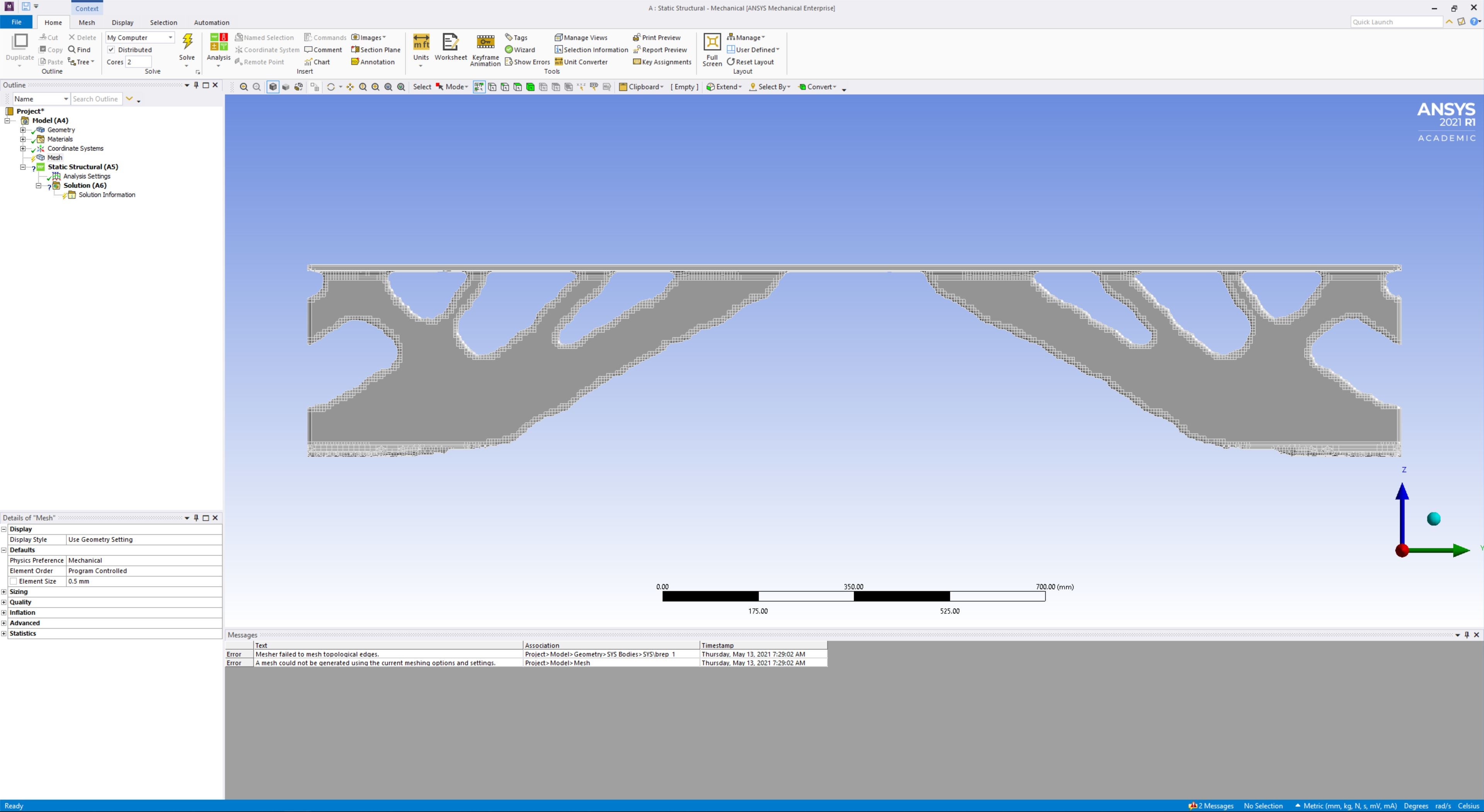

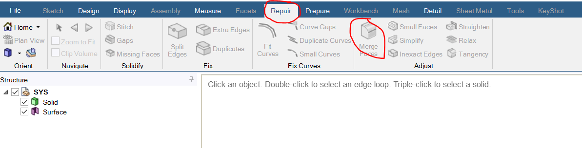

Can you try removing those edges by using repair >extra edges in spaceclaim.
Also, you can try simplifying your geometry with the geometry you have, as edges are not smooth. If you need any help with the spaceclaim, there are many courses available on Ansys innovation courses site. You can go through it. I have attached link for your reference.
regards amaniyar
May 13, 2021 at 7:14 amTejas_Kumar
SubscriberEdges remain, even after repairing.
Also, I did not create my geometry. It was created by a software. So, I don't know how I can simplify it.

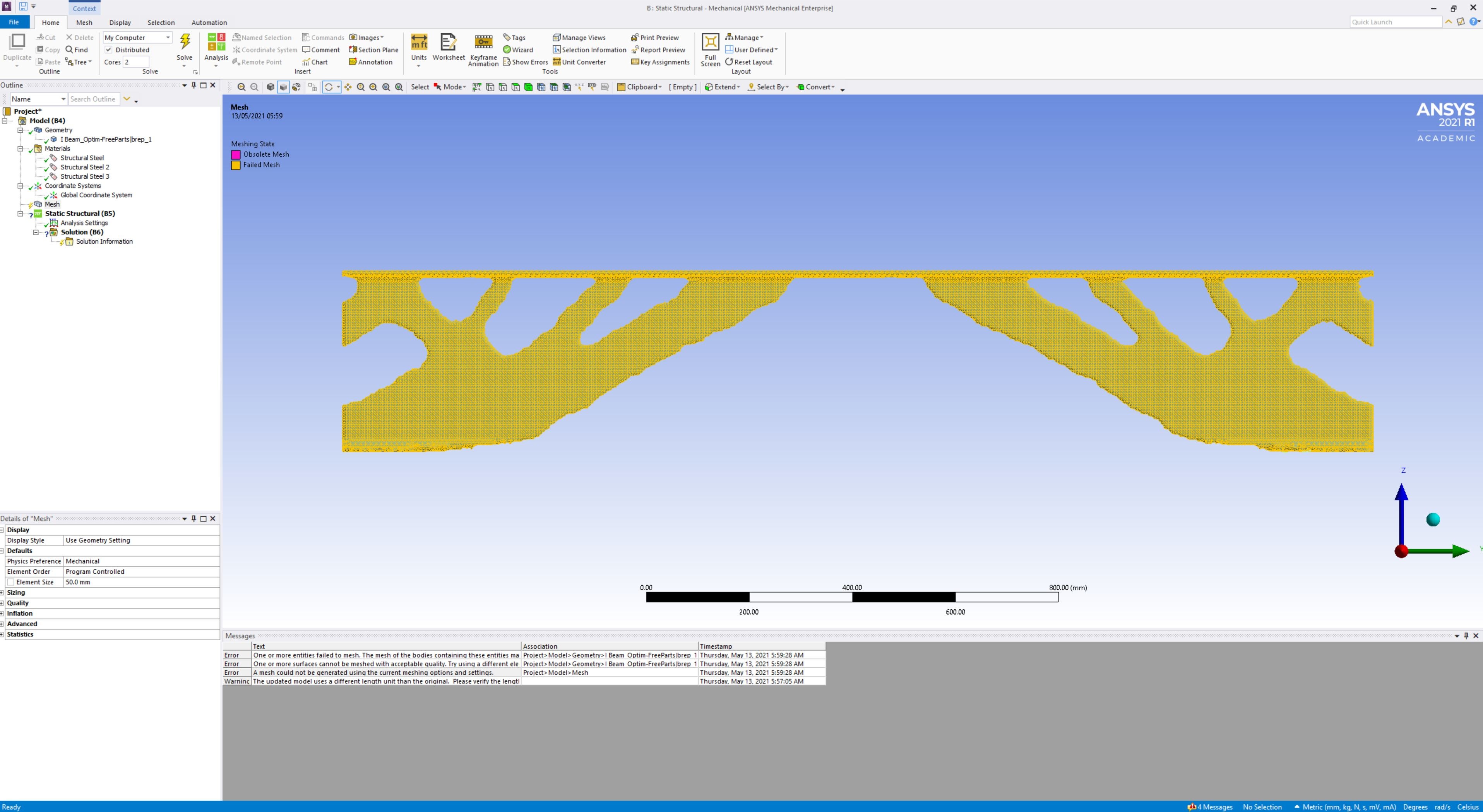

1)The geometry you would have got from topology optimization, I guess. If the thickness of middle part is constant, you can project the outer lines on plane and can make the edges smooth and again create the model by extruding it. This can simplify your geometry and then it will be easy to mesh. This can take some more time.

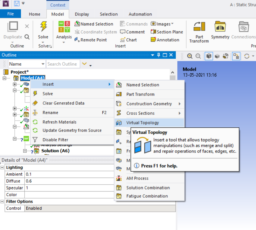

2)Also, you can use virtual topology option in Ansys mechanical to create virtual surface for meshing. You can try any of above methods.

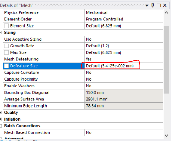

Also, I forgot to ask if you have tried with keeping mesh defeaturing on and given some value in image shown below. This can also help to mesh your geometry. (Capture curvature keep it off). You can play with mesh settings and try.
regards amaniyar
