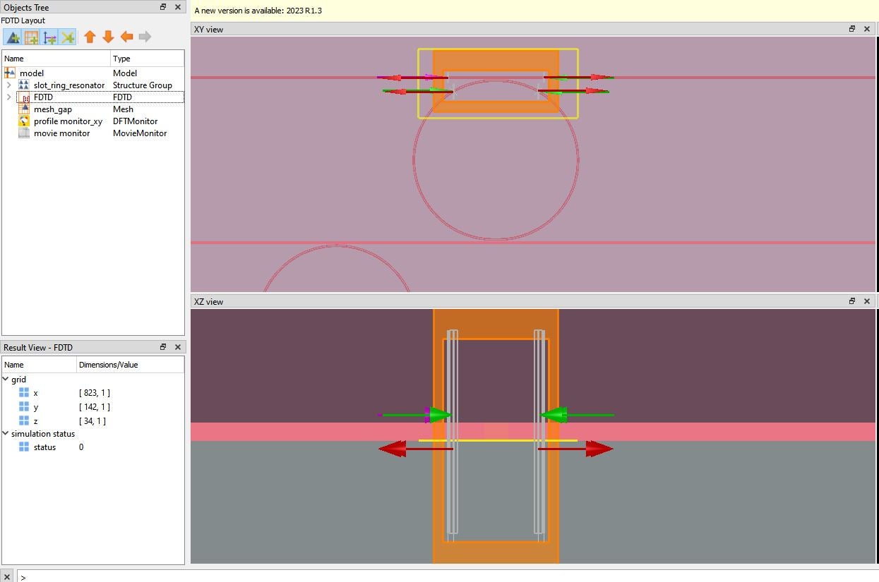

      Is there any method to simulate the optical power-induced TPA of the ring resonator? I want to estimate the optical damage threshold of the current waveguide.

      Sorry my question was a bit misleading. It's more like the loss induced by TPA effect due to high input power at an operating wavelength of 1.55 um for example. As from this ref (chrome-extension://efaidnbmnnnibpcajpcglclefindmkaj/https://par.nsf.gov/servlets/purl/10188756), how can I set input power so that I could probably observe the output power?
