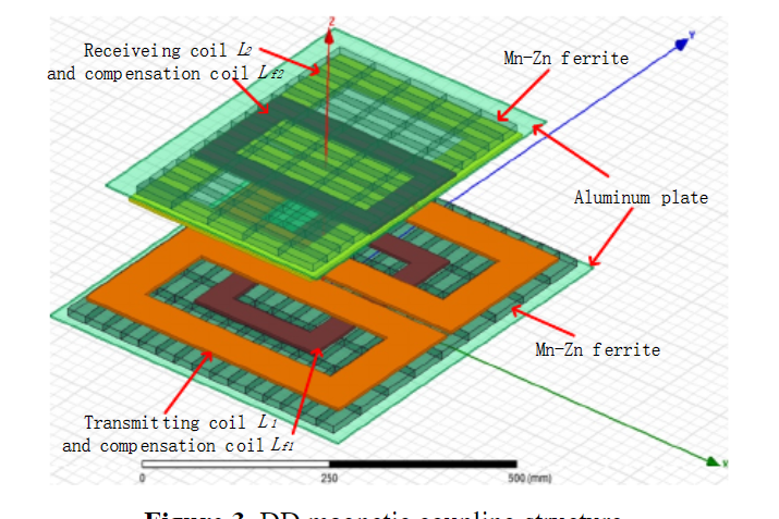

how to simulate dd coils using coil sheet
    • xduan916
      how to simulate dd coils using coil sheet, as the yellow coils are in series, so, how can we simulate it as series connection? 2、how to excite current for the coils, excite one coil or both two? For example, the transmitting coil and compensation coil sheet should connect in series,how to set in maxwell? use maxtix
       join in series?
    • GLUO
      Please add winding in excitation, create coil terminals and assign them to one winding.
