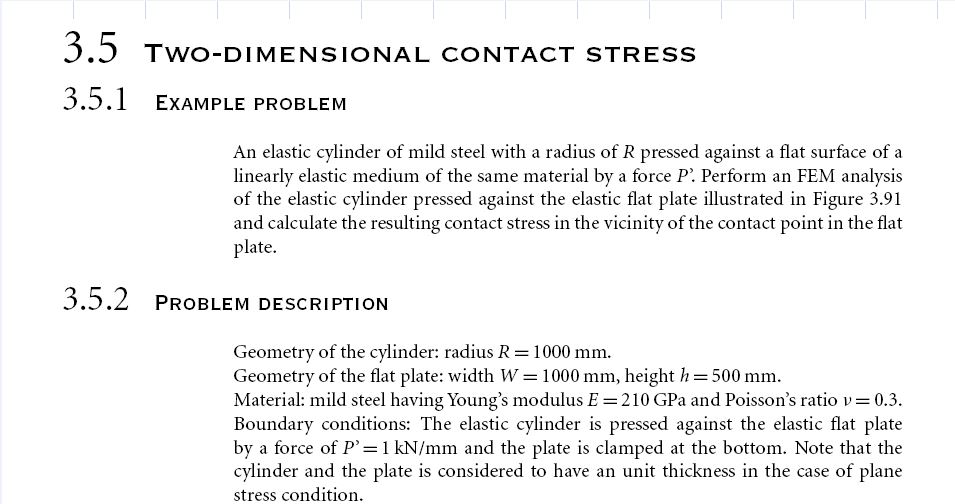

SubscriberI'm beginner of ANSYS APDL. I'm interested in contact stress.

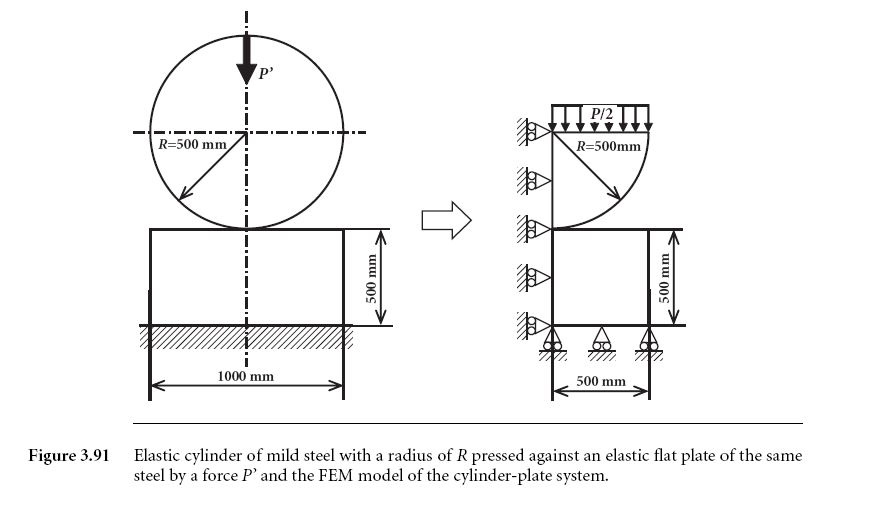

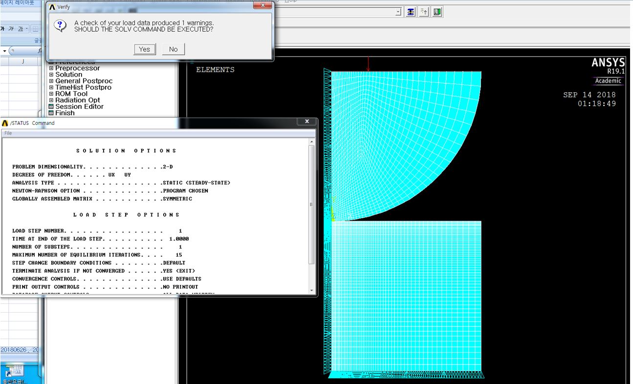

I have been trying for it with the text "ENGINEERING ANALYSIS with ANSYS SOFTWARE (Author: Y. Nakasone and S. Yoshimoto)".Â
The Contact stress problem is described in 120page ~138page in the text.
I have followed the text, But I can't get the solution and I have below error in solution phase.Â
I have added the capture image and code source for the contact stress simulation procedure.
Thanks.Â

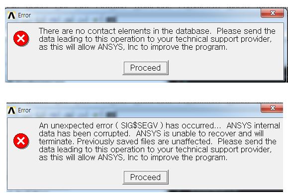

// Error //
"There are no contact elements in the database. Please send the data leading to this operation to your technical support provider, ..."Â
What is wrong ? Is there a problem related to making contact element due to ANSYS student version?

Ansys EmployeeSee ANSYS Verification Manual sample model VM211 which is a contact analysis with similar geometry for an example set of commands.
November 30, 2018 at 7:58 pmjpasquerell
Ansys EmployeeI looked over your input and do see two items that need addressed. 1) There are two lines with real, that should have a value after the comma. Try changing both to real,1. 2) The other issue is that everything needs selected prior to the solve command so add an allsel command just before the solve.

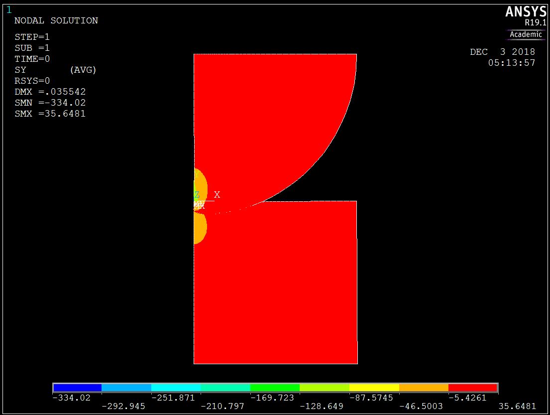

December 2, 2018 at 8:21 pmshinetutor
Subscriber Thanks jpasquerell !!
Thanks to your comment, I could solve my 1'st problem. (Real, 1Â and ALLSEL ALL )
But, I have still encountered another 2 problems.

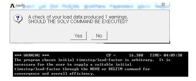

Problem 1. : timestep problem
Problem 2. : penetration problem

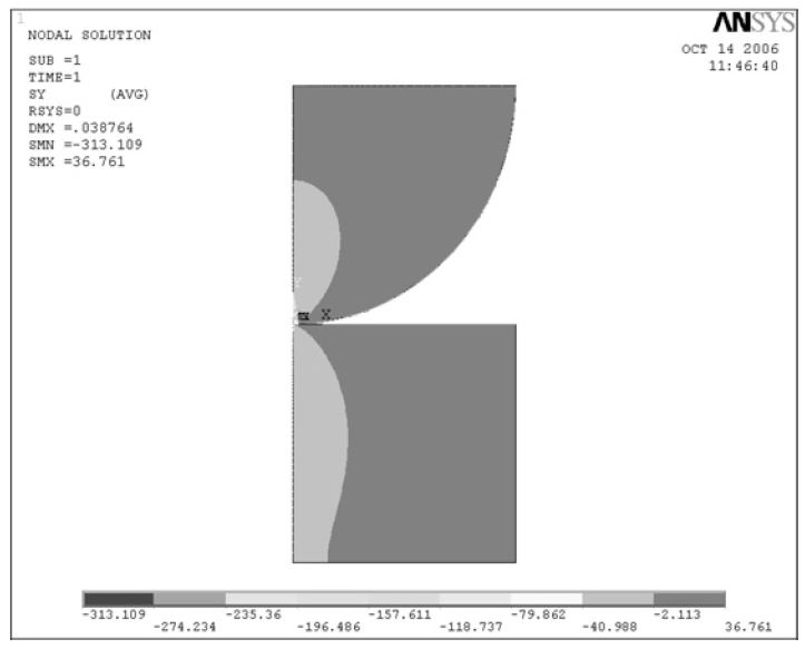

[Solution from Text]Â No penetration
What is wrong ?

December 3, 2018 at 10:35 amjj77
SubscriberAs someone mentioned, there is a similar example in the verification manual (VM191). Have a look there.
Also as you will see there, first impose a small enforced displacement to active the contacts, and then remove it as you apply the pressure. Otherwise if you apply a pressure it can be difficult to catch the contact. Finally you can do it in workbench which is easier, and then export the .dat file for reading into the APDL. Attached is the apdl code from WB.Â

Subscriberregarding your problem 2 related to penetration i think it is just the magnication of result you can set true value option in post-processsing while plotting nodal solution. but one thing is strange to me why there is Time,0 mentioned in the coloured picture while Time,1 in the black-white picture. please check that as wellnDecember 23, 2020 at 11:11 amkrada
