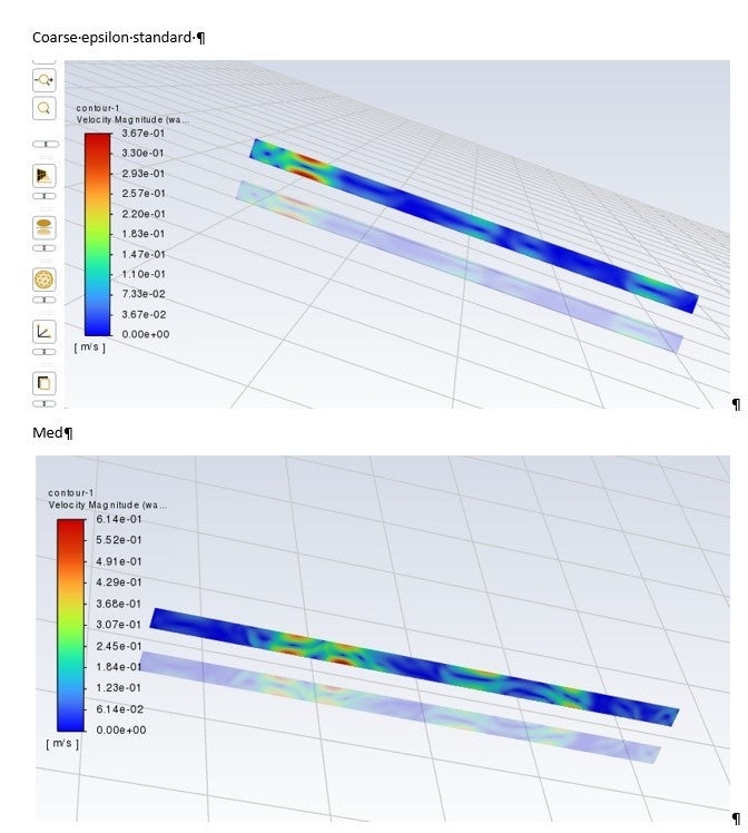

    • Jjoonnaass
      So, I have tried simulating this case with the free surface as a wall boundary. However, changing the mesh size or turbulence model leads to completely different results in the velocity profiles. Do you have any advice on what I can change to get more stable results?
    • Amine Ben Hadj Ali
      With Open Channel Flow I assume the pressure profile is "described" by Fluent using the neighborhood VOF. In Eulerian that does not exist and you need to do that on your own.
