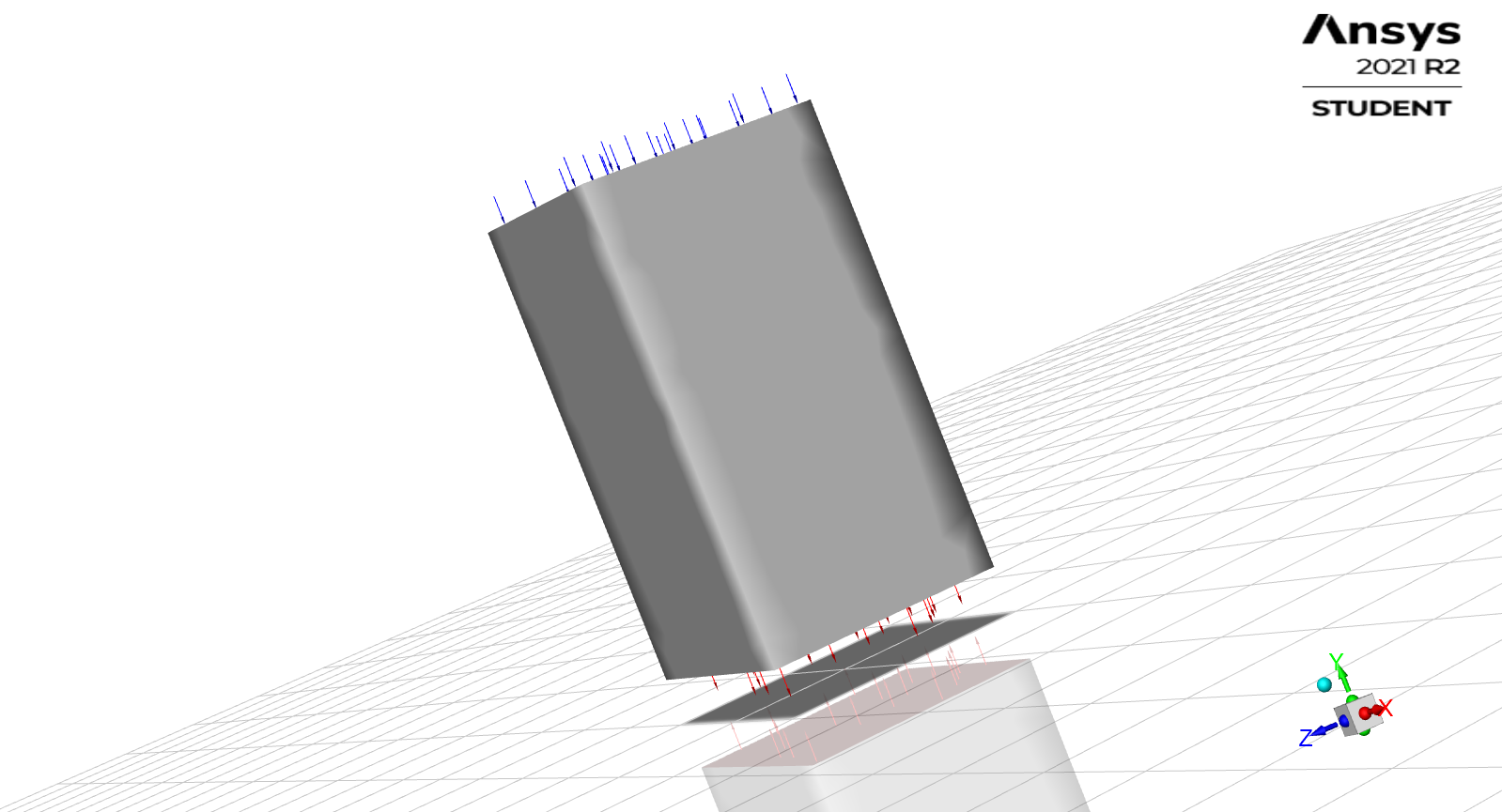

October 1, 2023 at 6:43 amOctober 1, 2023 at 6:46 amAslam SAIFI
SubscriberI am doing cfd on the propeller.
I have some question if any one can help me on these.
1. In the above uploaded picture, i have to rotate my propeller 6000 rpm in clockwise direction about x axis if looked from top view ( from psitive z axis) , so what value shoud i have to enter, positive 6000 or negative 6000.
