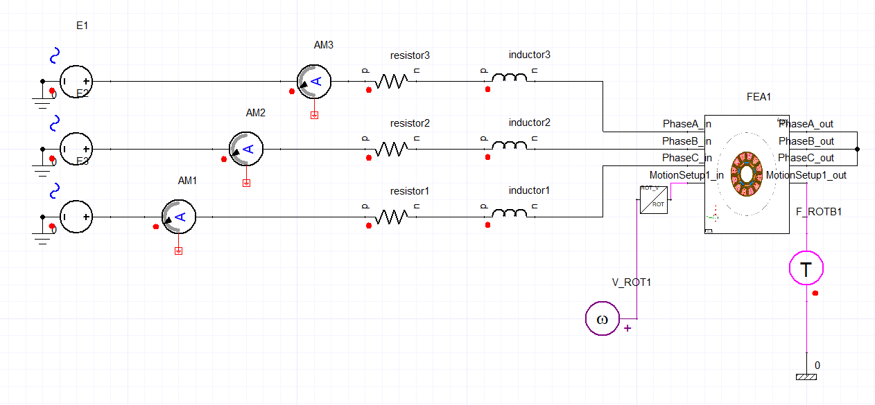

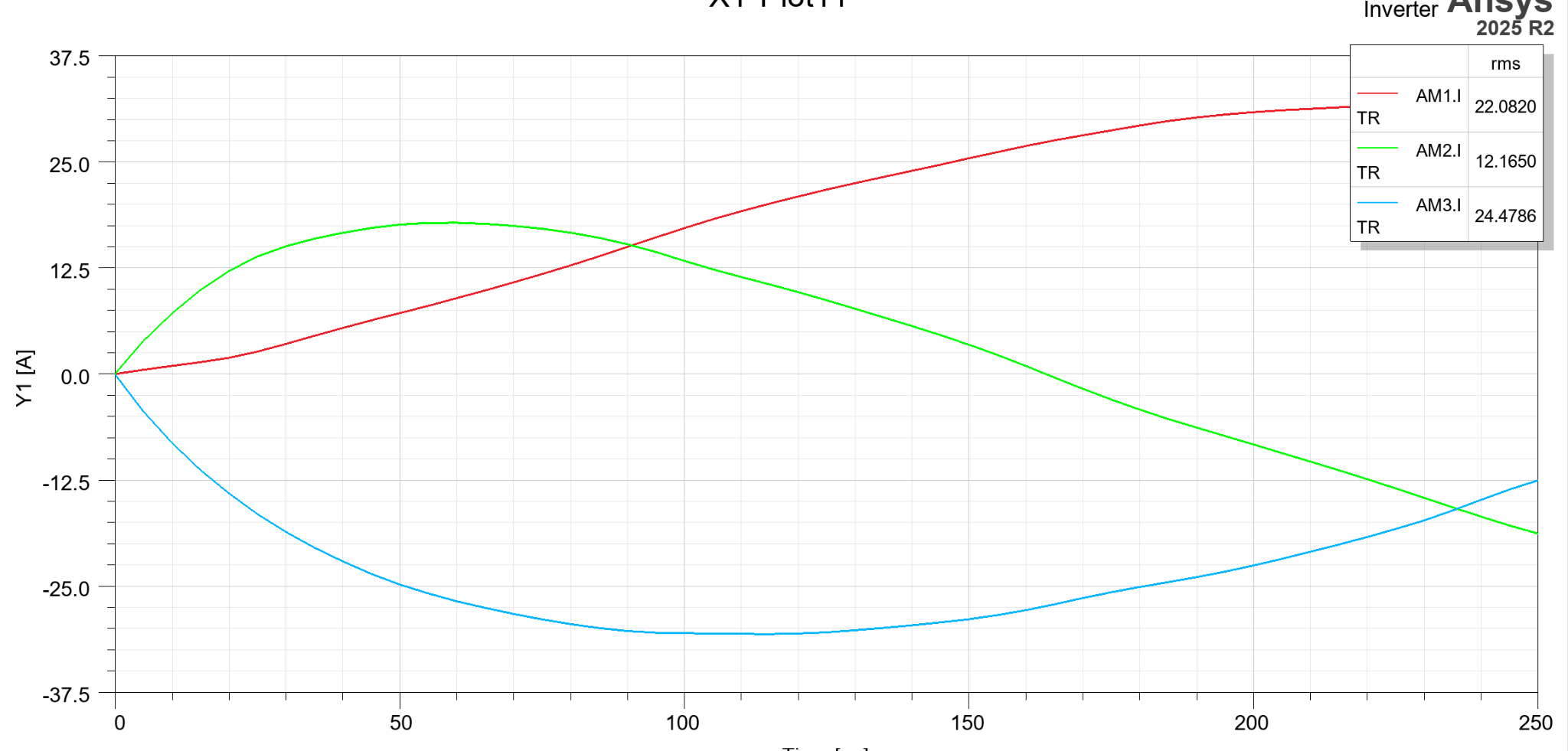

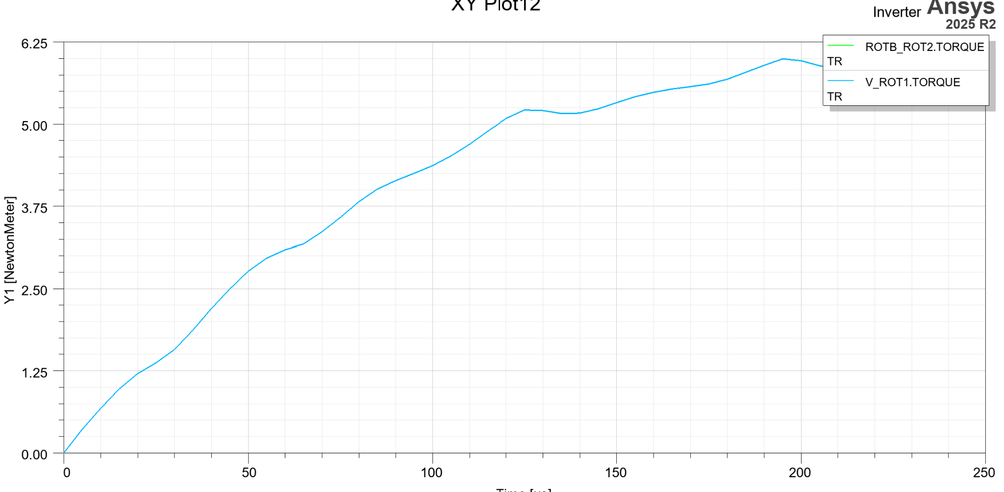

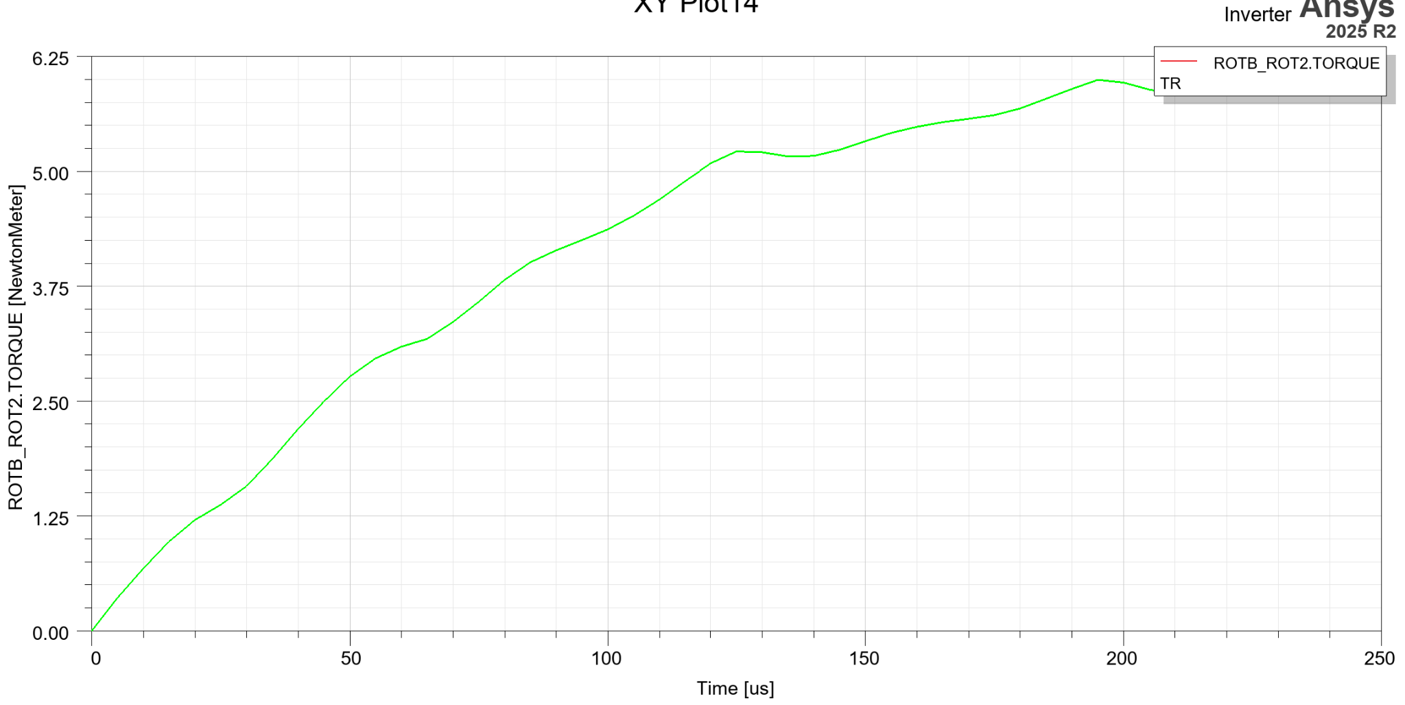

SubscriberHello, I am trying to design a PMSM in Maxwell and Simplorer. I am interested in working on optimizing setpoints (torque, speed) and am trying to figure out the best way to setup my simplorer model. The input speed and frequency of the sources is matched at 14000 RPM (1166.667hz), but when I adjust the load torque the torque output and current waveforms don't change. How do I set this up correctly so I can run the motor at setpoints (14000rpm 12Nm for example)?
I don't currently have any constraints on the simplorer side but would like to keep the simulation as simple as possible (AC Current or Voltage sources)
1Nm applied
100Nm applied
November 25, 2025 at 2:28 pm
MirandaH
Ansys EmployeeHi, is the Maxwell model Transient co-simulation or equivalent circuit?
