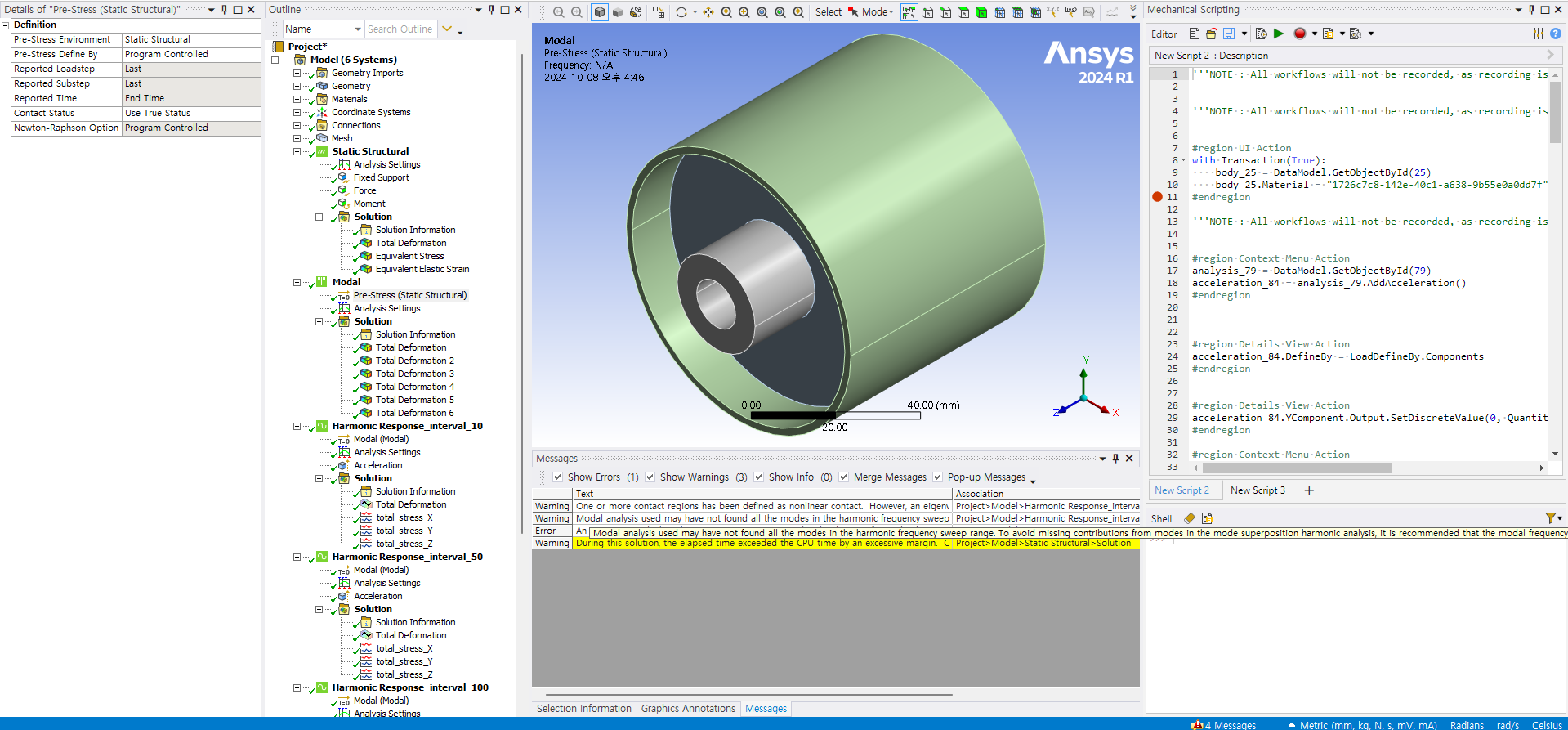

SubscriberHow To set pre-stress environment definition with the python code?Â
By use ansys pymechanical codes, LikeÂ
mechanical.run_python_script('''Âinitial_condition = DataModel.GetObjectById(82)Âwith Transaction():Â Â initial_condition.PreStressDefineBy = PreStressStateType.ProgramControlled''')Â, But, this code can't set the definition none to static structural. How can i set this definition by pymechanical code? -

Ansys EmployeeHi
See this post where it is done using mechanical scripting like you show in your image above:
https://discuss.ansys.com/discussion/4453/set-pre-stress-enviormentÂ
