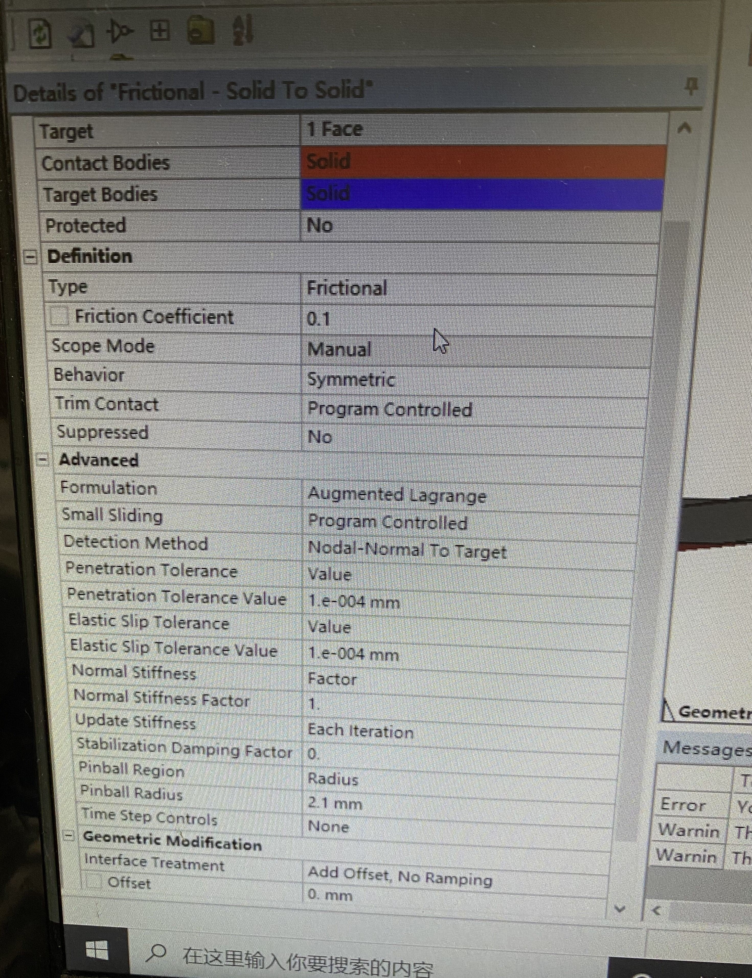

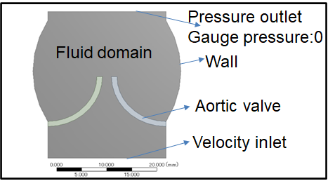

SubscriberIn my 2-way FSI of aortic valve, when the leaflets of valve close completely, the simulation failed for the splitting of the fluid domain. And I find the solution for this problem in a paper: a minimum distance should be imposed between the leaflets to keep a gap when the valve closed. But I don't know how to set such contact in ANSYS? Does any one know the setting way? Any help will be deeply appreciated.
November 14, 2021 at 1:36 pmpeteroznewman
SubscriberIn the Contact Details, use an Offset parameter to prevent the structural walls from touching when the Frictional Contact is closed.
November 14, 2021 at 11:43 pmNovember 15, 2021 at 12:14 ampeteroznewman
SubscriberI can see it on that image, it is the last line.
November 15, 2021 at 1:09 amnindoumon
SubscriberThank you for your kind reply.
I searched the use of offset.
In the referrence, it means to move contact detection by value.
Positive value brings two separated parts closer.
But I don't know whether it is right to set a negative value for preseving a gap between two leaflets.
Is it ok to set a negative value in the offset?
Help to hear from you.
Thank you very much.
November 15, 2021 at 3:30 ampeteroznewman
SubscriberYes, use a negative value of offset to leave a gap between the contact and target surfaces of a frictional contact when the contact elements are in the closed state.
