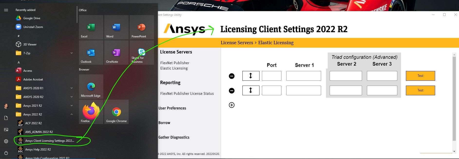

December 20, 2022 at 1:28 am
December 20, 2022 at 2:47 pm
dyat
SubscriberThanks again Mr. Raban for the info about the Licensing Client Setting GUIÂ program.
Is there a way to select the license server non-interactively (on a command line) in Linux?
December 20, 2022 at 7:43 pm
Waled Raban
Ansys Employee@dyat, yes,Â
To run the utility on Linux, type the following:
ansys_inc/v211/licensingclient/linx64/ClientSettings/ClientSettings
NOTE: v211 represents 2021R1, v212 represents 2021R2, v221 represents 2022R1, etc.
please refer to this help section for detailed information about this: https://ansyshelp.ansys.com/account/secured?returnurl=/Views/Secured/corp/v212/en/licensing/lmg_using_cls.html
