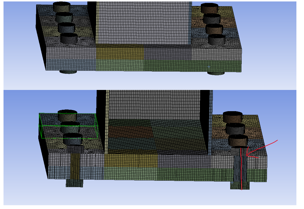

Simply i want to be able to select a line of nodes or even a single node within a solid, as shown in the image below i want to select a line of nodes at the centre of the bolt.

First of all, only if you have a split edge at the centre will the mesher guaranteed put nodes on that centre line - if there is no edge, then it can not be sure that the nodes will be on that centre line.

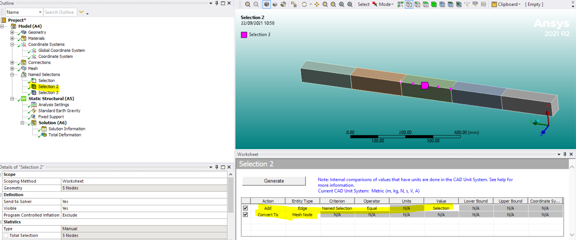

Having done the above, then one can select the edge, create a Named Selection - then highlight that named selection right mouse button click on it and choose create nodal named selection (that is shown below, created from Selection).

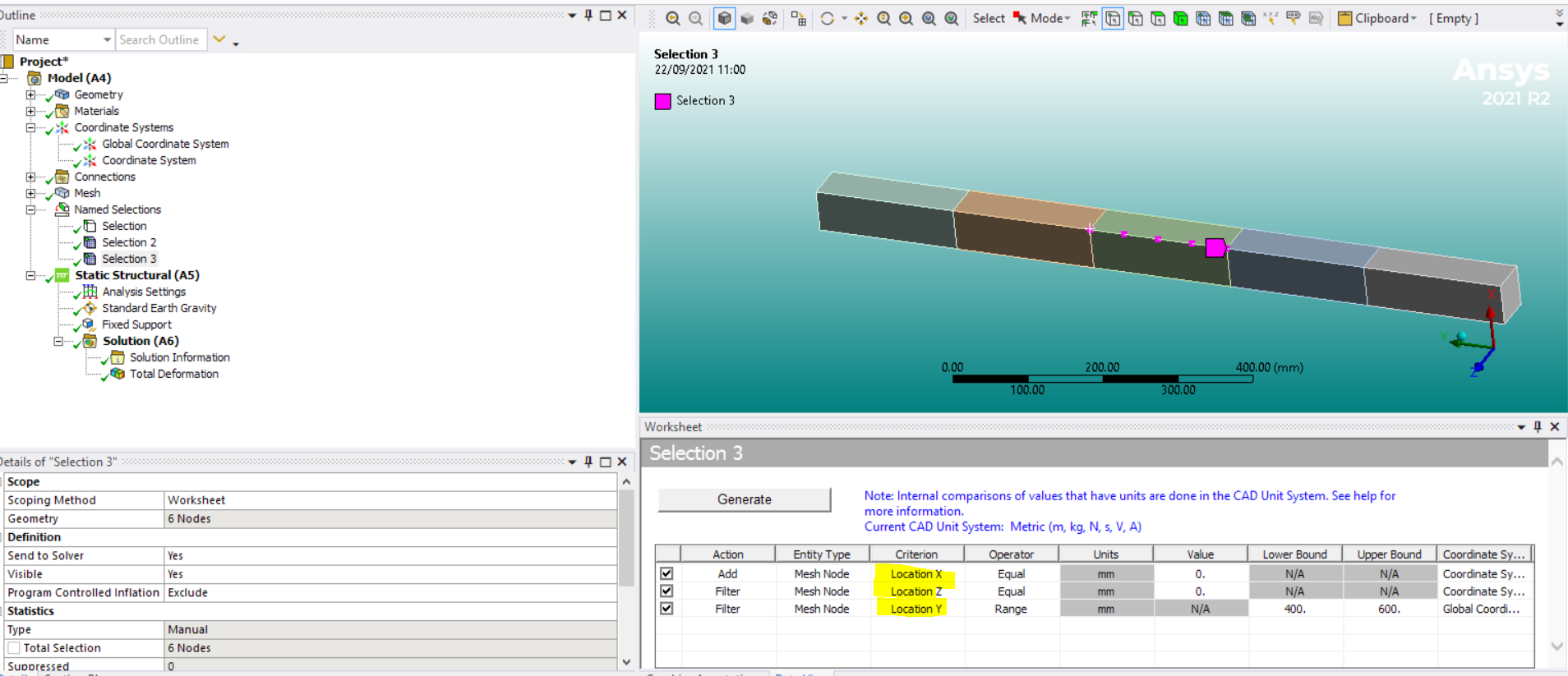

Another way is to use the worksheet in named selections to choose nodes at a certain location (you could define a local coordi. system there on the edge and use X=0, Y=0,.. to select them in the worksheet).

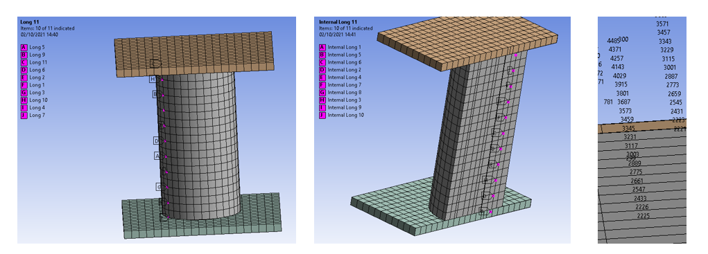

By way of an update i am carrying out a different simulation, compression test on a concrete cylinder. I wanted to plot stress vrs strain at regularly spaced nodes along a vertical line on the external surface (long1-11) and at another parralel line within the cylinder (Internal Long 1-11).
To do this i turned on the node numbers and orientated themodel soi could read the node id's. It is not elegant but in this instance it worked.
