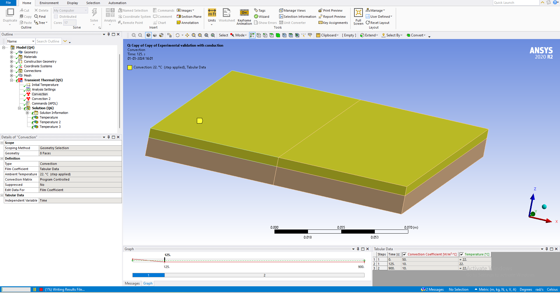

      Hello everyone!

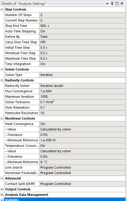

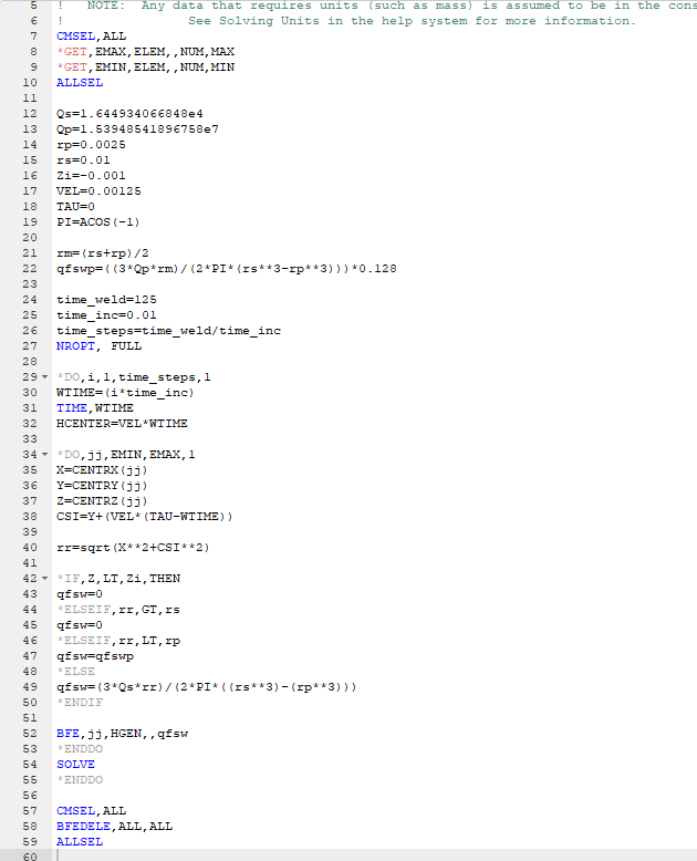

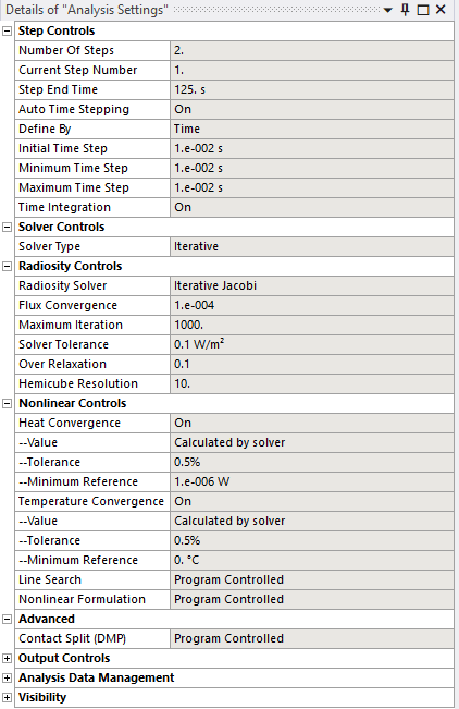

      I am doing a simulation of 2D moving gaussion heat source in ANSYS Transient Thermal and I am unable to get a smooth temparture curve. The values are deviating a lot. Initally I started with program controlled and then when I was geting huge spikes in the curve I then switched to iterative solver. I have tried to reduce the timestep but still the curve is all spiky.
      So what can I do to optimise the time step for my problem so that I can get a convergent graph.
      Also is there a way to check simultaneously that the solution is converging or not like it could be seen in ANSYS Fluent with curves continously plotting.
      I am attaching a few pictures of the settings and APDL Commands that I am giving for refernce.

      The problem is you are running in batch mode.  If you were in the APDL gui and you cut and pasted your commands into the input window (or input them from a file), then you would see a real time convergence graph.  You could add /gst,on,on to your commands.  That would write a file.gst which could be interrogated in the APDL gui with the Results Tracker while the job was running.  Easiest of all is to just look at the solution output (Solution Information) as the job is running.
