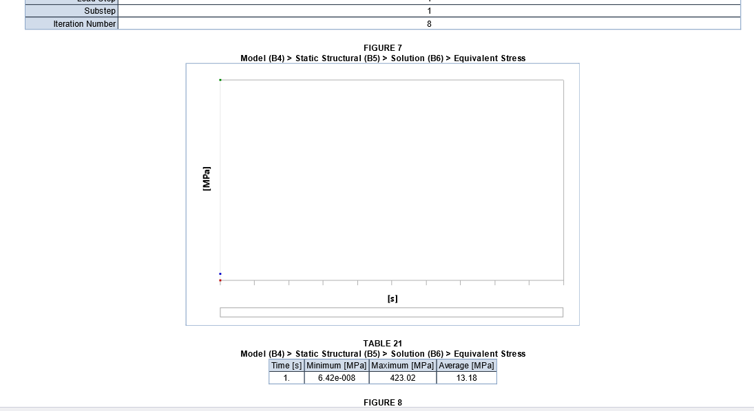

      Hi there,
      I have basic static structural analysis and I used Report Preview in ANSYS to automate the report generation. But for result plots, they are not shown in the report. Instead, only a blank graph and tabular data are included in each solution. Does anyone know how to remove this graph?
    • Saumadeep Choudhury
      The plot shown here is not blank. This is a Stress V/S Time plot and since your analysis involves static loading, hence the "point" on the stress axis (Y-axis) shows the MPa being applied.
      If this had been a transient analysis, you would have seen the stress vary w.r.t time.
