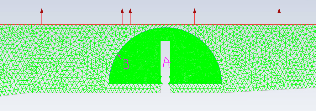

I am trying to refine this half-circle region in fluent, but fluent keeps identifying the perimeter of it as a wall. So when I run a case where a wave is supposed to crash onto the device (part A), it ends up crashing on part B.
How would I go about refining the mesh of this particular region without creating a wall?

Ansys EmployeeIt looks like there is non conformal interface at B.
You will need to do share topology at the geometry level to get conformal mesh.
Please check following videos
