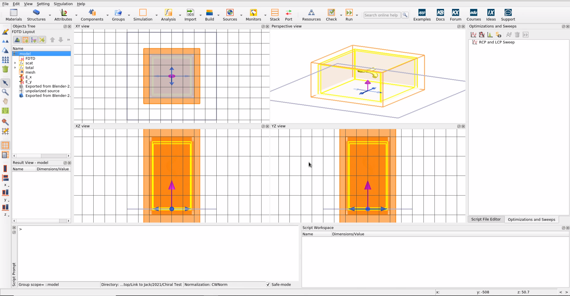

I have been trying to simulate the circular dichroism spectrum of various chiral materials. My setup is basically an ordinary simulation box with orthogonal plane-polarized wave sources out of phase by (+/-) 90 degrees to create RCP/LCP light. I saw other forum topics about this and I believe this is the convention. The issue I keep running into is non-convergence to the auto-shutoff level (currently 10^-6). Any other non-polarized sources reach the auto-shutoff quickly (< 2 hrs). I have attached an image of the workspace to give a better idea, but please let me know if there is any other information I should include. The spring model in the simulation box is not my end-goal but was created to hopefully speed up troubleshooting as it should exhibit CD properties.

Ansys EmployeeThis is a typical slow converging issue. From the screenshots, it seems you used finer mesh along the propagation direction, throughout the propagation. This makes the PML thin, and it can reflect back and forth. To remedy, it is generally suggested that just uses the background mesh accuracy (2 by default, do not use much higher mesh accuracy) plus override mesh to resolve geometries if necessary. Please test the case without the override mesh. In addition, please use Steep Angle PML, and increase the number of layers.
Circular polarized light is different from a linearly polarized light in terms of light-matter interaction. Otherwise you would not use it.
In case the issue cannot be resolved successfully, you can simulate two different polarization and then combine the results by post processing:
Ansys Insight: Custom TFSF source
You may also check if it has higher diffraction orders with very large diffraction angle, say over 70 deg or above. If so please use Steep Angle PML with more number of layers.
