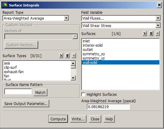

If you need 20 points on your X axis, you could create 19 planes along the length of the helix to cut the surface into 20 pieces and use the Surface Integral calculator 20 times to get the Y axis values. How many turns are in your coil? What is the helix angle? Perhaps you only need 6 planes to make 12 pieces per turn.

The wall shear is going to be constant along the entire length of the pipe after the entrance length. You could to slice the pipe into a few divisions along the entrance length until the flow fully develops into a constant wall shear.
