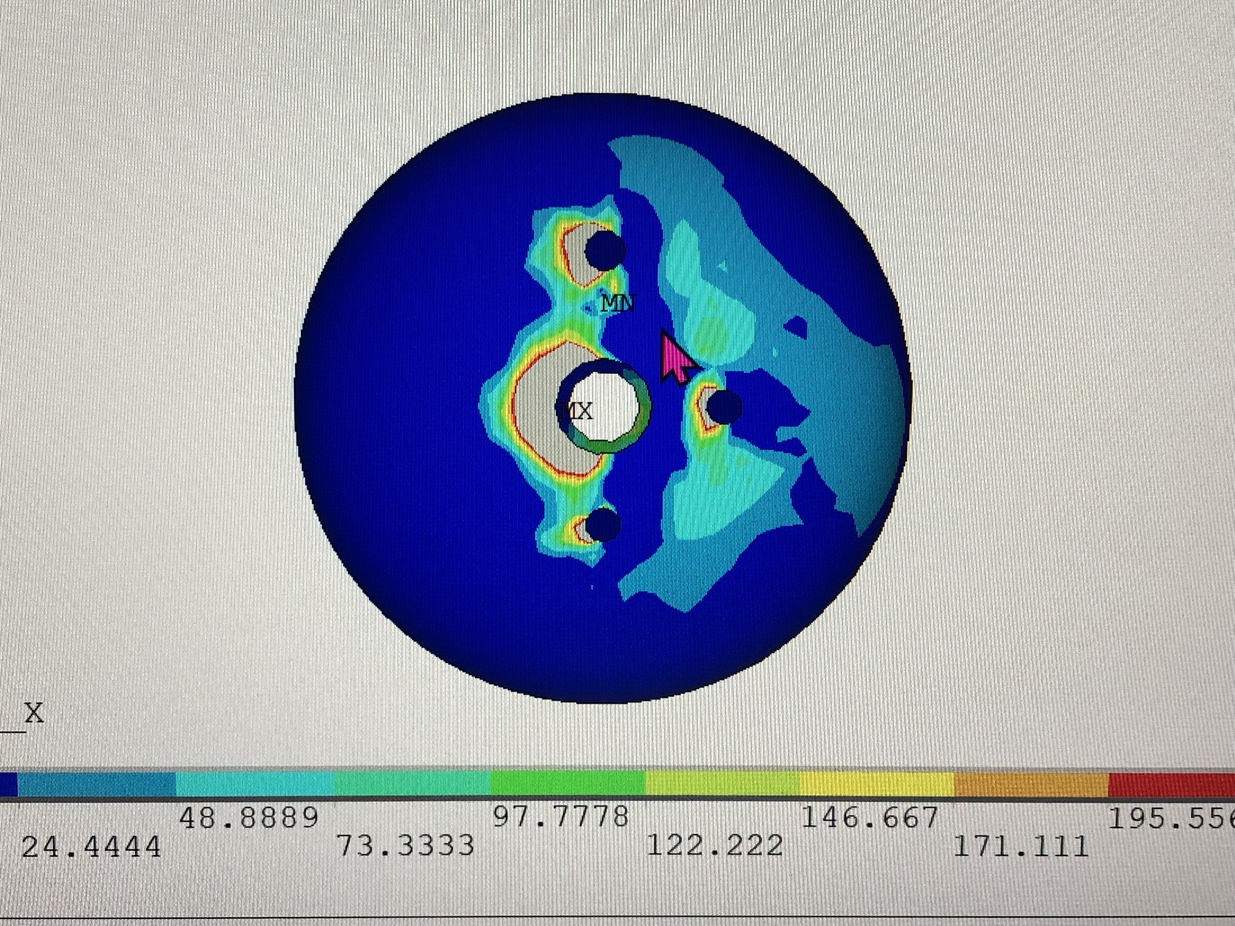

SubscriberHey guys,how to plot a contour with user defined stress range.Just make the contour below do not display the elements in freeze area? Thank you guys, don’t care my poor english pls.and this is nodal solution

Subscriberthanks but my means is not change the legends or something, I need to hide the elements which stress value exceed my range when I plot contour . Maybe it is a difficult issue to fix
February 14, 2022 at 10:42 ampeteroznewman
SubscriberUse the Capped Isosurface plot. In the link below, I am showing how to plot elements above a threshold, but you can use it to plot elements below a threshold.
