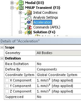

      I don't know if this will help you. I got help from a talented support engineer at SimuTech Group. Below is a description of what he created for me.
      I had a Transient Structural model that had tabular input for the Acceleration load which varied over time. There was only one load step. The time history was very large, 42,000 time steps with three values per step (xyz), which is 126,000 numbers. Workbench almost chokes on this many numbers and takes forever to submit to the solver.
      Instead, I put the 126,000 numbers in a text file, and used a command snippet to read the text file.
      The load now just has three numbers, 1, 1, 1 for xyz accelerations.
      The command snippet is this:

      The text file was created by writing out the input file once using the agonizingly slow Workbench and finding this section for the text file.

      nIt doesn't read the file because you have spaces in the folder names. Save the project and the text file to a path that has no spaces in the file name or folder names. nYou have a mistake on line 12, you are missing an _nReading the file is all the linking needed.nI recommend you prove out the concept on a file that has 100 rows of the data before you try to run the full load case.n
