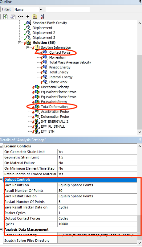

      I would like to plot contact load vs displacement so i have in the output controls turned on contact forces and inserted the result tracker for contact forces. End time is 0.06 seconds. I am using Ansys 18.2
      How can i match the results for contact force and deformation so that the plots are equal in data point numbers like 150 points for each plot ?

    • Chris Quan
      The frequency of results tracker output under Solution Information is defined by Save Results Tracker Data On as well as Tracker Cycles in Output Controls.
      In the picture as shown in your post, program will output results for results trackers at every cycle. If your model has run 100,000 cycles, the results trackers will have 100,000 data points.
      You can increase the Tracker Cycles from 1 to 100, this will reduce the number of the results tracker data points to 1000.
      Or, you can change the Save Result Tracker Data On from Cycles to Time and specify Tracker Time to output results tracker data.
      If the End Time is 0.06 sec and 150 data points are required, the Tracker Time can be specified as 0.06/150 = 0.0004 sec.

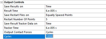

    • Tony6
      So i have changed the analysis settings as in the following image based on your comment. What about the output contact forces in the settings? I would like to plot contact force vs deformation so both axis need to have same nb of points. Using the result time and tracker time, this would mean 0.06/1000 = 6e-5 seconds. I am not sure however if the total deformation result would have 1000 points now or not and if that would slow things down massively. I also dont know if i should change output contact forces to also be based on time with 6e-5 seconds
    • Chris Quan
      The Output Contact Force creates .cfr files that include contact force at all nodes that are in contacts. It is not related to the time history plot of contact force under Solution Information. Furthermore, these .cfr files cannot be processed directly inside Mechanical GUI at the current release.
      If you open the .cfr files using a text editor, you will see the nodal number in the first line and the second line lists three contact forces in X, Y, Z directions. You may use spreadsheet to organize these data and re-arrange them to get two columns of data (cycle number and contact forces) for each contact node. Please be aware that not all nodes in your model are participated in the contact calculation. Only a small portion of the nodes are involved.
      You can also look at the admodel.log in the MECH folder of your project to associate the cycle number with time. From these information, you can plot time history of contact force at the selected contact nodes.
      If you want to plot the relation of contact force vs deformation, you can create a new results tracker of directional deformation under Solution Information. By doing this, you can make sure that both contact force and deformation have the same number of data points and are corresponding to the same time increment.
      You need to be aware that the contact force results tracker is scope to a body or multiple bodies while deformation results tracker is scoped to a vertex or a node. So make sure you select the vertex/node strategically so the deformation from the results tracker can be properly related to the contact force results tracker.
