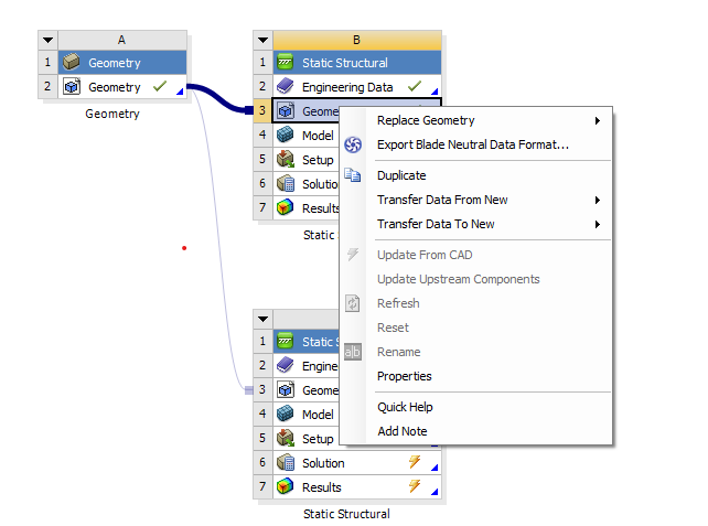

      I just downloaded Ansys mechanical , but unfortunately I cannot open the Design modeler by Double Clicking on the geometry. It is also not an option when I click right.
      my preferred geometry editor is set as design modeler.
      What can I do ?
    • Kishan Konannavar
      Hello
      It could be because you are clicking on the geometry that is linked to another geometry. Try clicking on the parent geometry
