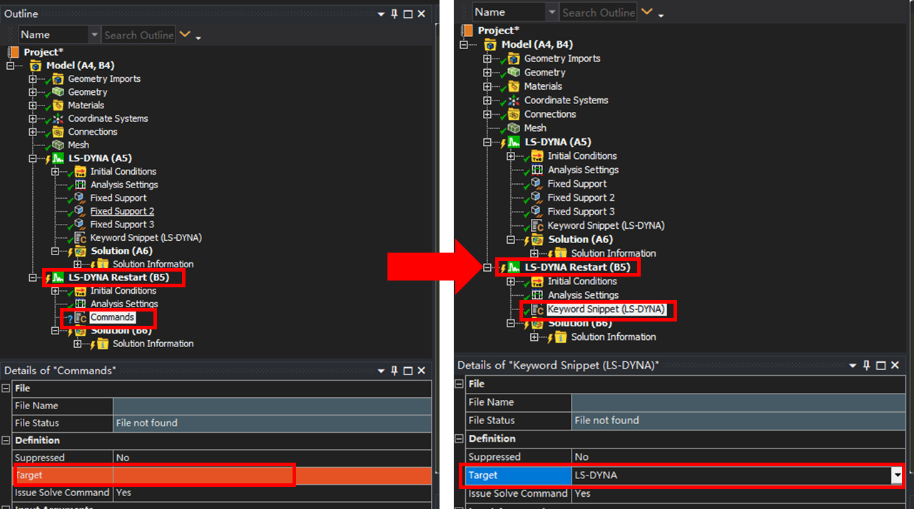

      In Workbench, when adding keywords with Command in LS-DYNA, its SolverTarget property is automatically assigned to LS-DYNA (as shown in Figure 1).

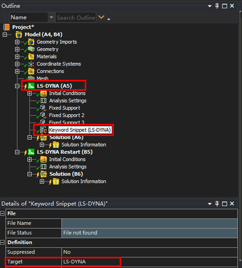

      However, when using Command to add keywords in LS-DYNA Restart analysis, the SolverTarget property needs to be modified manually (as shown in Figure 2), and this operation is not recorded in the script (as shown in Figure 3).
      How to modify the SolverTarget property for Command by using the script?

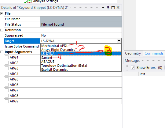

      Hi,Can you try this,
      "command_snippet_57.PropertyByName(“CommandEditorSolverTarget”).InternalValue=3"

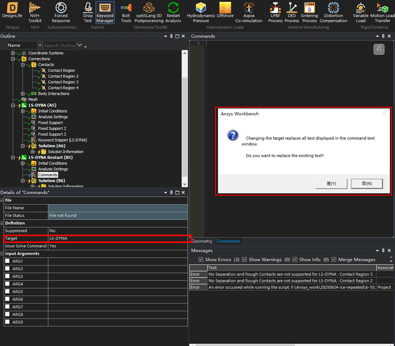

      Thank you very muchfor your generous reply. This command is very useful! I can modify the SolverTarget of the command successfully.
      But after the modification, I have to manually click yes in the pop-up window to execute the subsequent code. Can this operation be controlled by a script?

        It might be challenging to interact with pop-up messages directly using a script. However, as a workaround, you can try the following approach:
        analysis24 = DataModel.GetObjectById(24)
        command_snippet = analysis24.AddCommandSnippet()
        command_snippet.Input = ''
        command_snippet.PropertyByName("CommandEditorSolverTarget").InternalValue = 3
        Please give this a try and let me know how it works for you.
